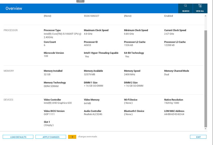

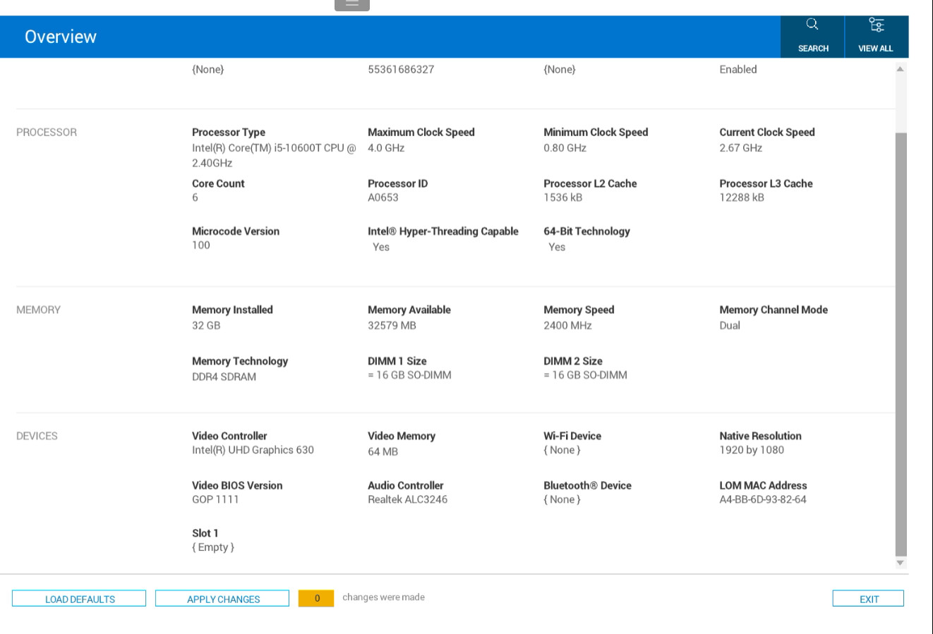

When looking at the Bios (image attached), I’ve determined that Devices > Slot 1 is referencing the PCIE slot. When a GPU is installed, it just reads {Empty}. When I tried the M.2 drive or ethernet card, it would display a valid value (like Storage Controller or Network Controller).

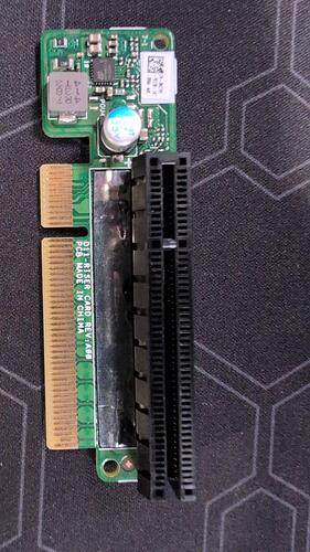

Did i miss you stating that the GPU riser is tested and fully functional? Dont see that…
Can’t you test that riser on another system board?
EDIT: Have you look for Dell documentation on that riser PN… and related 7090 system board for supported devices by it?
You do have confirmation for dGPU support on that riser PN right?

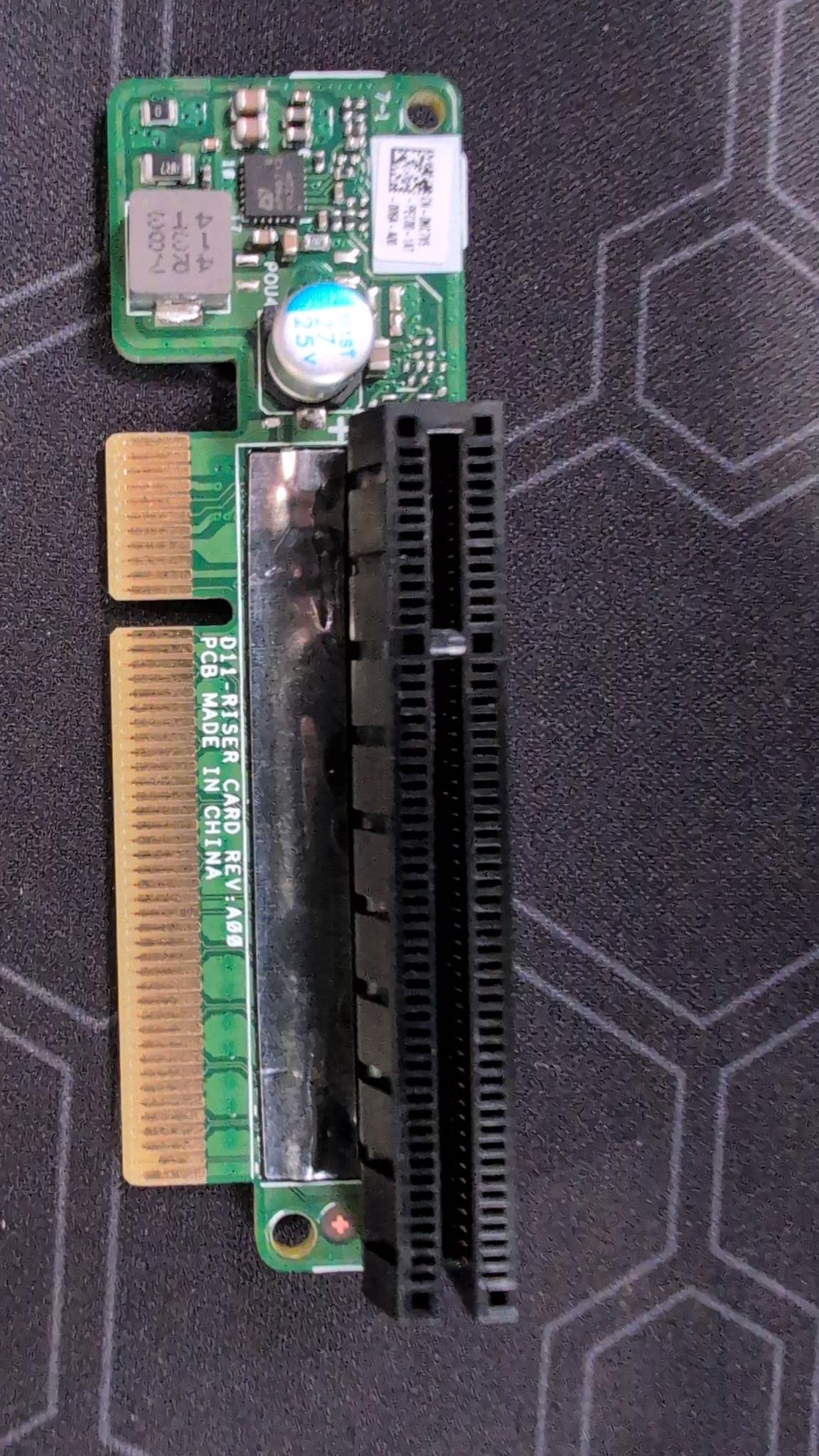

Sorry, I should clarify, the riser looks to be proprietary and is built into the bracket (but easily removed). All testing has been through the riser, so I can at least partially verify it works as the NIC and m.2 card work through it.

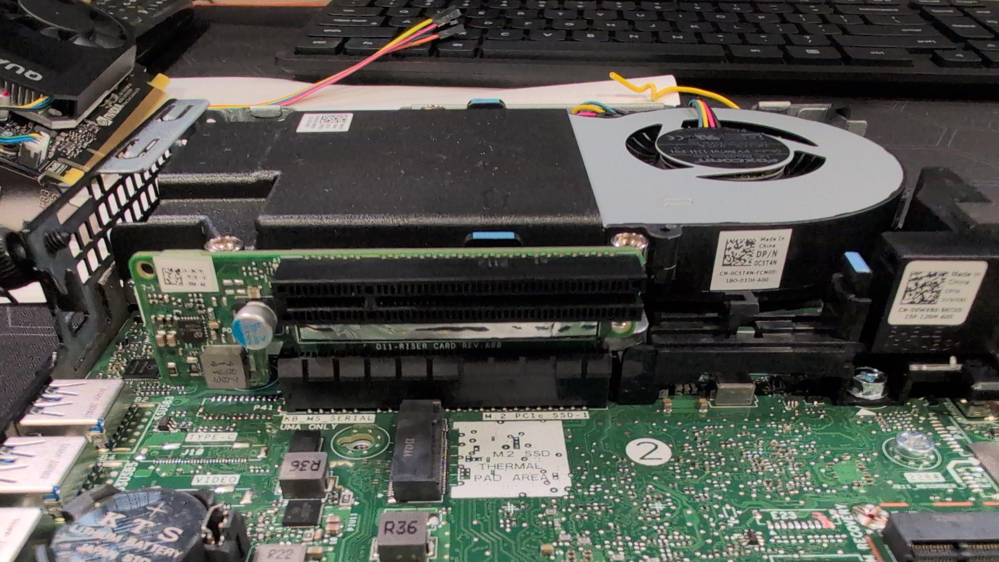

Second Photo
