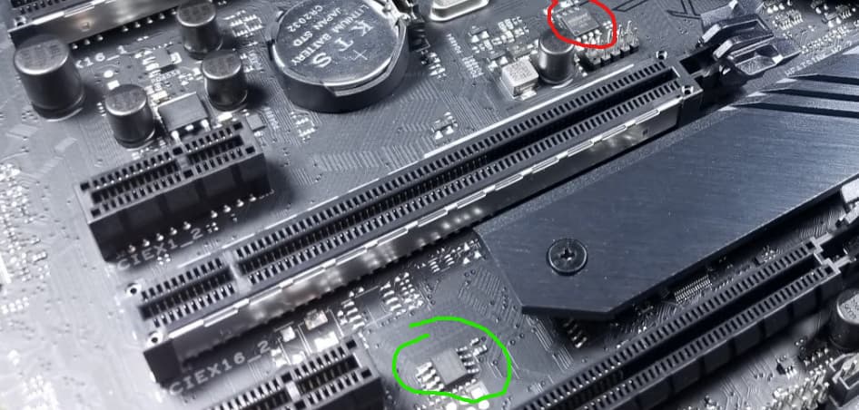

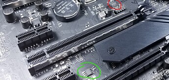

I’m assuming this guide should work with this or this? Is it imperative that I identify the chips? I can’t read them at all and I can’t get any decent photos of them. To the naked eye it looks almost as if there’s no text on them because it’s so faded.
And yes, it is imperative to identify it and search online for their respective datasheet. And yes, it’s hard to clearly identify them a naked eye, a magnifier/phone camera zoom are enough.
So contrary to what I expected a magnifying glass combined with my prescription glasses worked out a lot better than my old digital camera and my mother’s iPhone. The chip you’ve highlighted in green appears to be “Winbond - 25X05CLNIG - 1923” and the red one should be “Winbond - 25Q128JVSQ - 1917”. A quick Google search turns up this and this. Is it safe for me to hook up the programmer without the voltage adapter?
Yes it should, as you can see by pdfs, the voltage range of each one.
Dump the 2, but we’ll be focusing on the assumption of only need to recover main bios IC, the larger one 128Mbit. Secondary, depending on mb model could EC/TPU/iROG
So once I’ve backed up both chips I’m assuming I should attempt to flash the stock Asus BIOS onto the “red” 25Q128JVSQ chip by the CMOS battery? Do I just flash the .CAP file with FlashROM or does it need modification? The guide doesn’t seem to address that, but I believe I did see some mention in other threads of outputting the body with UEFITool to “remove the header”. I’m also guessing we’ll need to splice the MAC, serial, etc. from the backup?
