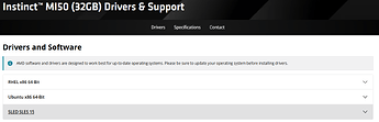

Hum…isn’t this a device only supported in Linux environment???
Help Flash MI50 to Radeon VII Pro | TechPowerUp Forums
How to test an AMD Instinct Mi50/Mi60 GPU : r/LocalAIServers
Seems like it is, I don’t mind using it on Linux either, but it’s also not getting picked up there. From the second post you linked it seems that the card is just dead, so I’ll probably have to return it.
