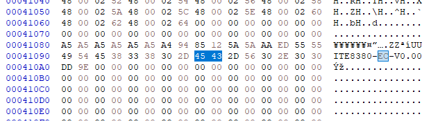

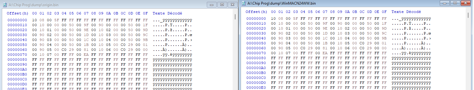

I trimed MACN24WW with Hex Workshop to make it the same size as my original dump. I flashed MACN24WW. The pc starts, keyboard backlights turn on but that’s it. Can’t boot to windows.

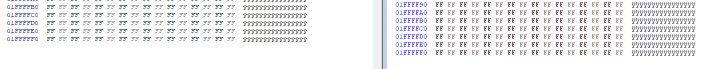

So I read my current bios with Neoprogrammer, it was mostly empty, mostly it was full of FF FF FF …
I read later on that I needed to use UEFItool to copy some parts of my dump into the new bios. It’s been a week I’m trying to comprehend/learn how to get system data, UUID, serial, etc but I’m stalling.

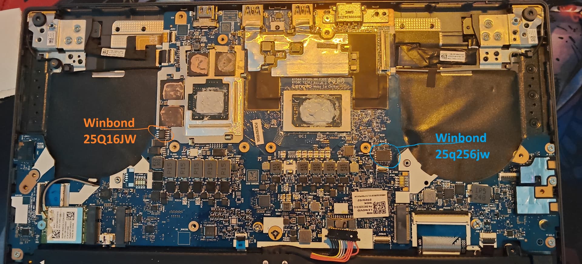

Wait, the EC/ME are not in the same dump I’ve done from W25r256jw chip ?
There’s another chip, smaller on the board, Winbond W25Q16JW.
Do you know what this chip is for ?
I don’t understand what this chip is for. Should I dump this one too ?
About the trimming, I followed a tutorial telling me to make sure the new bios starts and ends at the same offset as the orginal bios dump to get the same .bin size file.
Sir… i dont have all the mbs model here living sleeping eating with me…
Im not going to lose my time to check every user model mb information to know if there’s 1 3 4 56 ICS on the fk mb…this is user information to provide.
Small IC is vbios, did you bothered to even check IC model and storage capacity… its a 2Mb IC
