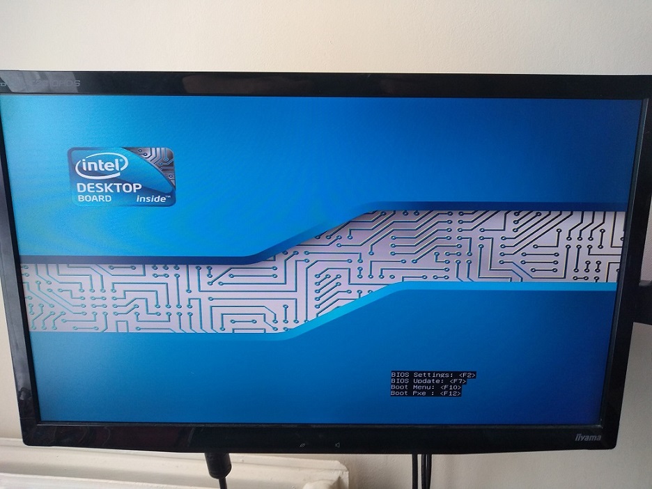

I can boot to BIOS now but the motherboard hangs on this screen unless I press a functiun key.
If I press F10 to choose a boot device, the list of devices appear but when I press Enter to boot from a device, the motherboard hangs.

I have turned it on today and there was a boot screen I have not seen before with the BIOS specifications :
AMERICAN MEGATRENDS
Version 2.14.1219
2011
Bios date : 12/05/2012 18:07:07
Ver : BE
I can enter BIOS but I can not boot from any devices.
F7 is BIOS update hotkey but it does not work.
F12 is boot to network hotkey and it does not work.
F2 is BIOS interface hotkey and it works.
F10 is boot devices choice hotkey and it works.
When I press F10, I can see the list of devices from which I can boot but
if I double click on one device, it does not boot and the motherboard freeze.
When I press F2 I can see the BIOS interface but if I change the boot order to boot on
a bootable USB key or hard drive and I save it and reboot, the motherboard does not boot on
the first boot device. It stays on the screen where you can see the hotkeys choice.
