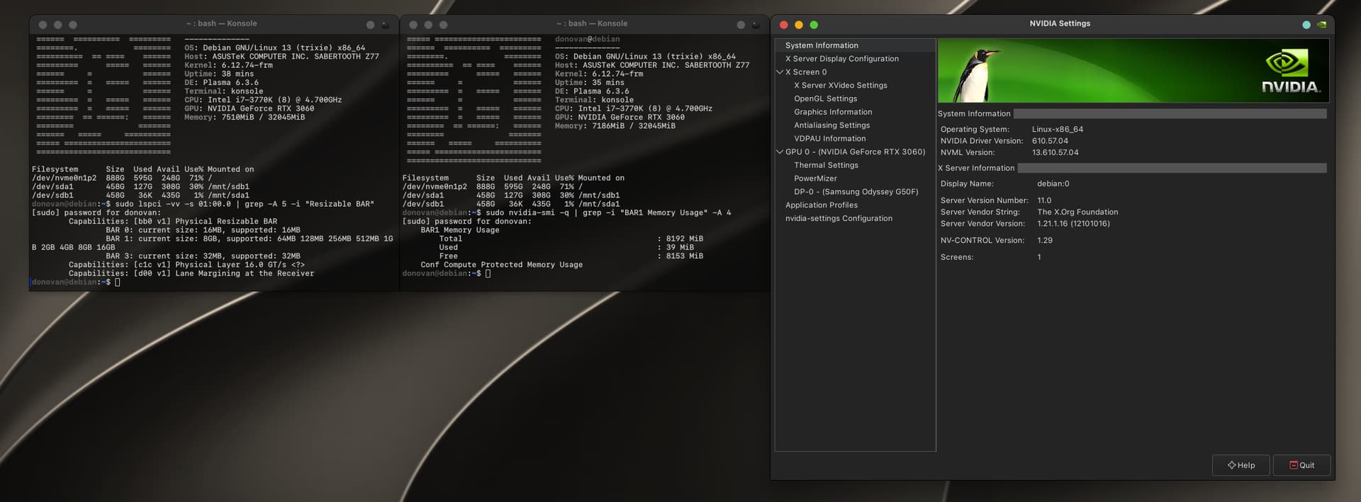

If everything works fine and rebar is working, and if you dont mind, could you please take a screenshot similiar to this:

Everything is working properly so far! Thank you for helping me get this working and I also apologize for the late response as life got busy.
I flashed the modified BIOS using BIOS Flashback, not CH341A. NVMe boot is working successfully and I was also able to get ReBAR working with the ReBarState method. Also, I like the new boot screen, what a cool touch you implemented!
I’m running 32GB DDR3, so as you mentioned, the ReBAR size is limited to roughly 8GB on this platform. I’m currently on Debian with a custom kernel and newer Nvidia drivers so the photos were taken off off my command line.
I’ll continue testing and benchmark it to make sure everything is stable. Thank you again for your help with this! Also, I uploaded a post on r/overclocking forum on Reddit thanking you and showcasing the build if you want to go check that out.
