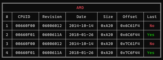

082FE.zip (4.4 MB)

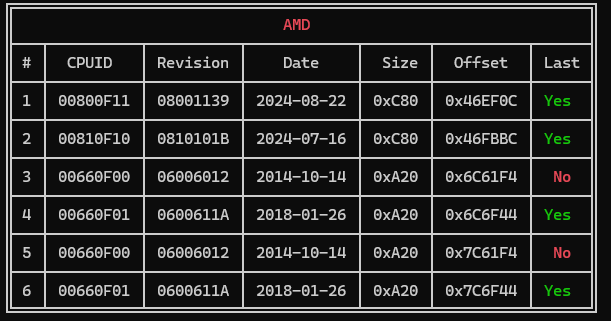

adding zen Summit Ridge mcode (Ryzen 3 1300X)
and zen Raven Ridge mcode (Ryzen 3 2200G)
will test -and update this post in a few days.
-testing 2200G at later date, as i do not have that chip on hand yet.
if above works(1300X/2200G), i try add R5 3600 (Matisse), but i’m very doubtful about Zen+ or even Zen2 for this bios/motherboard combo.
