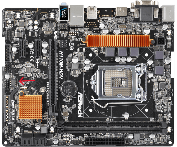

Well bad luck this time haha, no display, no POST. No beeps.
welp i didn’t expect that will happen (⁠•⁠ ⁠▽⁠ ⁠•⁠;⁠).
CH341, NeoProgrammer.
unplug power source and cmos
Determine first your IC bios 3.3v/1.8v (it could be Windbond, Gigadevice, Macronix, etc.) via Detect IC, Read the IC twice to make sure the CRC32 is still not changing then save the file, after that click delete then click Blank Check, open the file stock bios from official web (Instant Flash option) then click Write.

Hi Karfel, no problem. There was a chance it could happen. I don’t have the programmer, and even if I did, I wouldn’t know how to desolder. So I’ll send the CPU to a computer lab that repairs motherboards. The repair isn’t that expensive, and they’ll be up to date. I was reading Github for common issues, and these motherboards either have problems with the SATA controller (h110m hdv R.30), or my LGA 1151 processor might not post.
Another thing is that I always update the ME firmware to the latest version and the microcode, patching the bios reading a forum in this place long time ago. Maybe it was that. Who knows, haha.
I leave it here for further testing.
Hi @karfel again haha, I saw that in your new version you’ve added some actualized things like GOP, VBT, VBIOS, and other things. I haven’t reprogrammed the BIOS chip yet due to work issues. One question: Is it advisable to reprogram it directly with the modified BIOS, or should I reprogram the chip with the original BIOS and then try programming it with this modified BIOS? I could ask the technician to try it since he has the reprogrammer. What do you think? Or should I stay still? haha. Greetings.
in my opinion, better reprogram first with modded one, so you don’t have to come back twice to repair shop lol.

Ok, i reflash the chip BIOS again with stock bios, @karfel i see you did a little things haha. How’s the progress going with adding 4G to the H110M? I also saw that the modified BIOS is now working without bricking, but it’s not worth it if it only recognizes 1GB. I’ll keep an eye out to see if you can add the 8GB. By the way, belated Merry Christmas and an early Happy New Year. Cheers, mate.
I’ve already given up, better to cross flashing with the same PCIe slot, I/O, chipset, and LAN controller than trying to use different PciBus and PciHostBridge from another motherboard. or just leave it as it is, as long as the system is still working. Anyway, Happy New Year lol.
