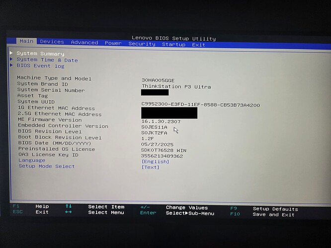

I have one. Post bios setup picture, please. Googleing didn’t work for me.
What exactly do you mean? Do you need a photo of every page in the BIOS? Of every main page or every subpage too? Or should I send you the structure as text?
Any page would do. A single photo in total.

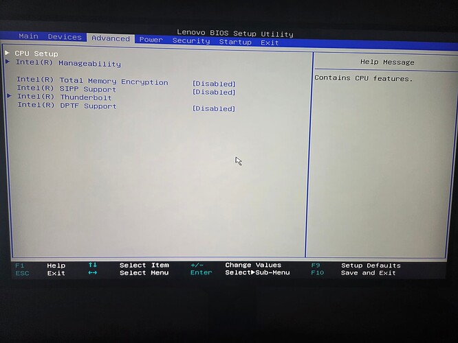

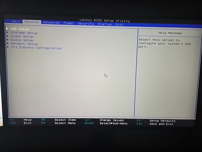

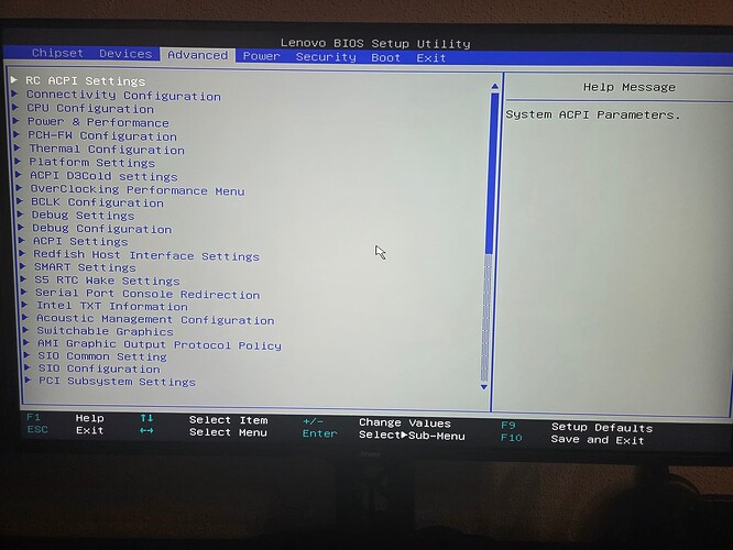

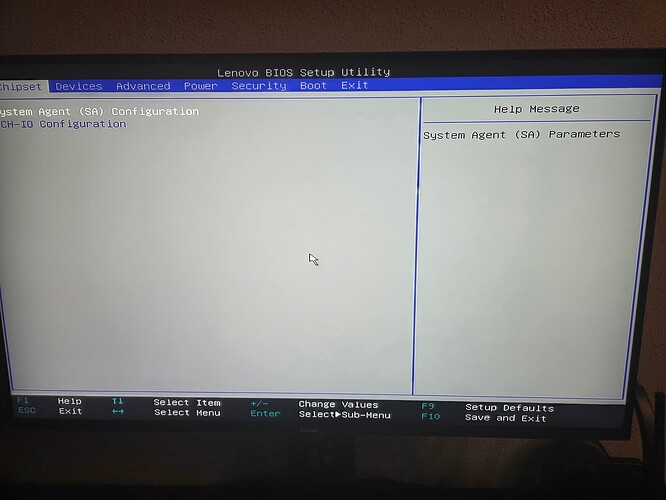

With the second CFG, a few things have changed:
1: The “Main” menu is now “Chipset” (see first photo)
2: The “Devices - USB Setup” menu now contains a lot of entries (see second photo)
3: The “Advanced” menu appears to contain the same content as “Devices > USB Setup” (see second photo)
Is the arrangement of the menus intentional?
I have also attached the logs from both configurations.
SREP - LOG.zip (1.9 KB)
If I understand how SREP works correctly, then SREP adjusts the EFI modules in RAM during POST. Would that mean that SREP does not make any permanent changes in the SPI (e.g. BIOS-Region or NVRAM)? Does that mean that the USB stick with the SREP configuration must always remain plugged in? If I make changes in the BIOS, these are stored persistently in the NVRAM independently of SREP, so it shouldn’t matter whether the USB stick with SREP is still plugged in after I have made the changes, right?
The order depends on Form Id value. You can’t see it from bios setup, but can in IFRE output.

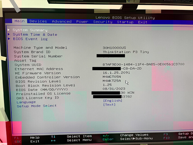

Hi,
I am looking to undervolt my Lenovo P3 Gen 2 Tiny. Unfortunately, the cpu voltage control is locked by default.
Could SREP be used to unhide the BIOS menus in P3 Gen 2 Tiny as well? Any help would be highly appreciated @Sweet_Kitten
Likely, yes. How can I help?
Thank you for your swift reply!
I just migrated from m920q to P3 Gen 2 Tiny and was bummed to find out you cannot unlock voltage control anymore by editing UEFI variables using RU.efi. My previous project was documented in a Reddit post.
If it is not too much to ask, a turnkey solution (that is, the contents of the SREP usb stick) would of course be greatest option. Just let me know what kind of further info you need from my side, provided that this is something you would be willing to do.
Thank you in advance!
Provided that I find uefi image on the support page, I’ll upload a solution soon.
Uploaded and tested on June 5th
