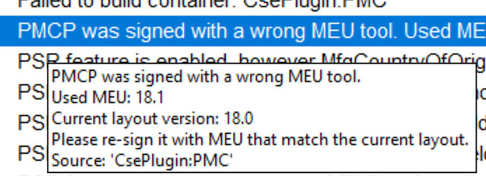

I am trying to bring it back to life after replacing CPU
I also tried to build with the same configuration, but with an older ME, the laptop won’t start. Just a cyclic reboot.

Try it with decomposed ME sub partition from the 01.01.07 Rev.A HP file…by the way what happened to the system to need a cpu replacement and what model now on it?

Already did… Same error.
Also tried with 01010400 (it has 18.0.5). Success, but no boot. I also took the BIOS Region from there. It’s all the same. The old BIOS has a ME size of 7 megabytes, but when I decompress ME from the System Update Image, it turns out to be 11 megabytes. Strange…
