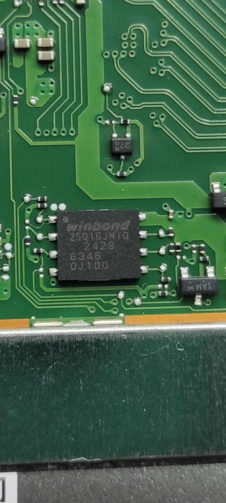

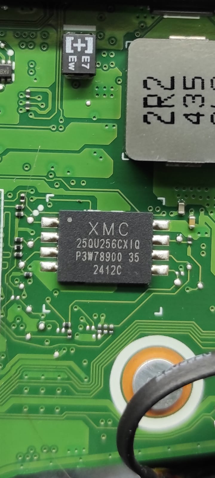

Hello! Could you please tell me the model of the main BIOS chip on this board? Many thanks in advance!

I asked this question here because I wasn’t sure which of them should contain the main BIOS firmware. I read the 25QU256CXIQ chip using an XGecu Pro T48, but it’s almost empty — about 90% of the chip’s memory is filled with FF.
Acer Nitro (Compal LA-K181P FH51S) UC7 XMC 256Mbit should be main bios and UV49 Winbond should be vBios
…the almost empty and mostly FF is usually not a “good” reading rigth???.. programmer model apart.

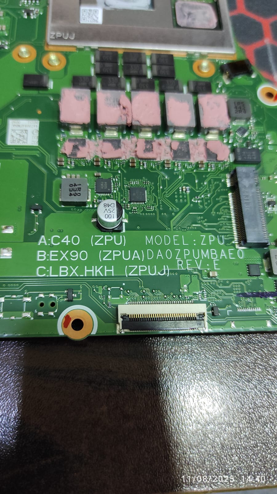

Presented user images seems to be related to model Nitro 16 AN16-42(43)
The fact that I read the data from this chip correctly is 100%.
So it could be a problem with the chip itself, or someone before me interrupted the BIOS flashing process at the worst possible moment?

EDIT: Do please attach exact laptop model info to the initial post, for better future user follow with similar issues, thank you
