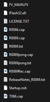

Please help, I can’t find the latest BIOS version for the motherboard “S5520UR” anywhere.
It needs to be updated, because when installing Linux Debian x64, an error appears - “ACPI BIOS Error (bug): AE_AML_BUFFER_LIMIT, Filed [CPB3] at bit offset/length 64/32 exceeds size off target Biffer (64 bits) (20220331/dsopcode-198)” and “ACPI Error: Aborting method _SB._OSC due to previous error (AE_AML_BUFFER_LIMIT) (20220331/psparse-529)”
Current version - “S5500.86B.01.00.0060”
Please help, maybe someone has saved the firmware.

Latest version seems to be S5500.86B.01.00.0069

Maybe it will help someone somehow, the maximum I managed to find was version BIOS64_BMC64_FRUSDR26_ME112 and BIOS69 - https://archive.org. I found mentions of the existence of version BIOS77, where they supposedly corrected ACPI, but I couldn’t find any information where to download or get reliable confirmation. I still couldn’t fix the error…
