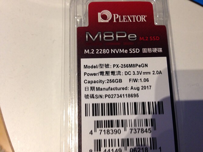

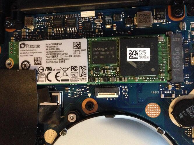

Hi, i buy this disk last week and try to install on it Windows 10, but when i put it in laptop and start laptop, going to bios in secion boot I see only my old hdd with system, I serching in evry forum I be and looking on similar problems to trying solve this but in my
situation not work any solve. This is list of what I trying to do:
1. When I disable fast boot and security boot and i next step enable CSM ( in some cases this should help) and reboot my laptop stuck on screen with logo and i cant do anything, cant open bios laptop do not respond. I must remove ssd from laptop and reload setings.
2. In remove old hdd and start boot bios only with ssd m.2 and dosent mater with or without enable/disable function (security, fast boot) in function boot is empty bios dosent see anything.
3. I put windows OS (usb stick) and try instal system on ssd m.2 and in windows instaler see my disk ,so ok I choise it so windows warning me the ssd is in GPT format (I solove this problem) and when again instal windows in gpt is succesfull instal I reboot and remove usb to try start boot from SSD. laptop start automaticaly Bios and in boot like alweys is nothing non disk.
when i startup normaly sys from old hhd and go to manager windows normaly see Plextor 256GB M8PeGN M.2, in computer section i see normaly disk can open and menage files copy delete etc. This is strange my laptop have only 1 year is brand new model so it is possible bios dosent have driver to this disk? I dont understand why this even happend? asus support send my a list with compatibility disk m.2 and only say they dont test more disk so they dont know is compatibly or not.
Ps. aplication /diskpart see SSD when i try change GPT to MBR they show information about ,it cant be do because this station is a dvd/or cd or removable station ?? this is strange.
Question is how to resolve this problem, what I must do to succesfuly BOOT Windows from m.2 ssd?
