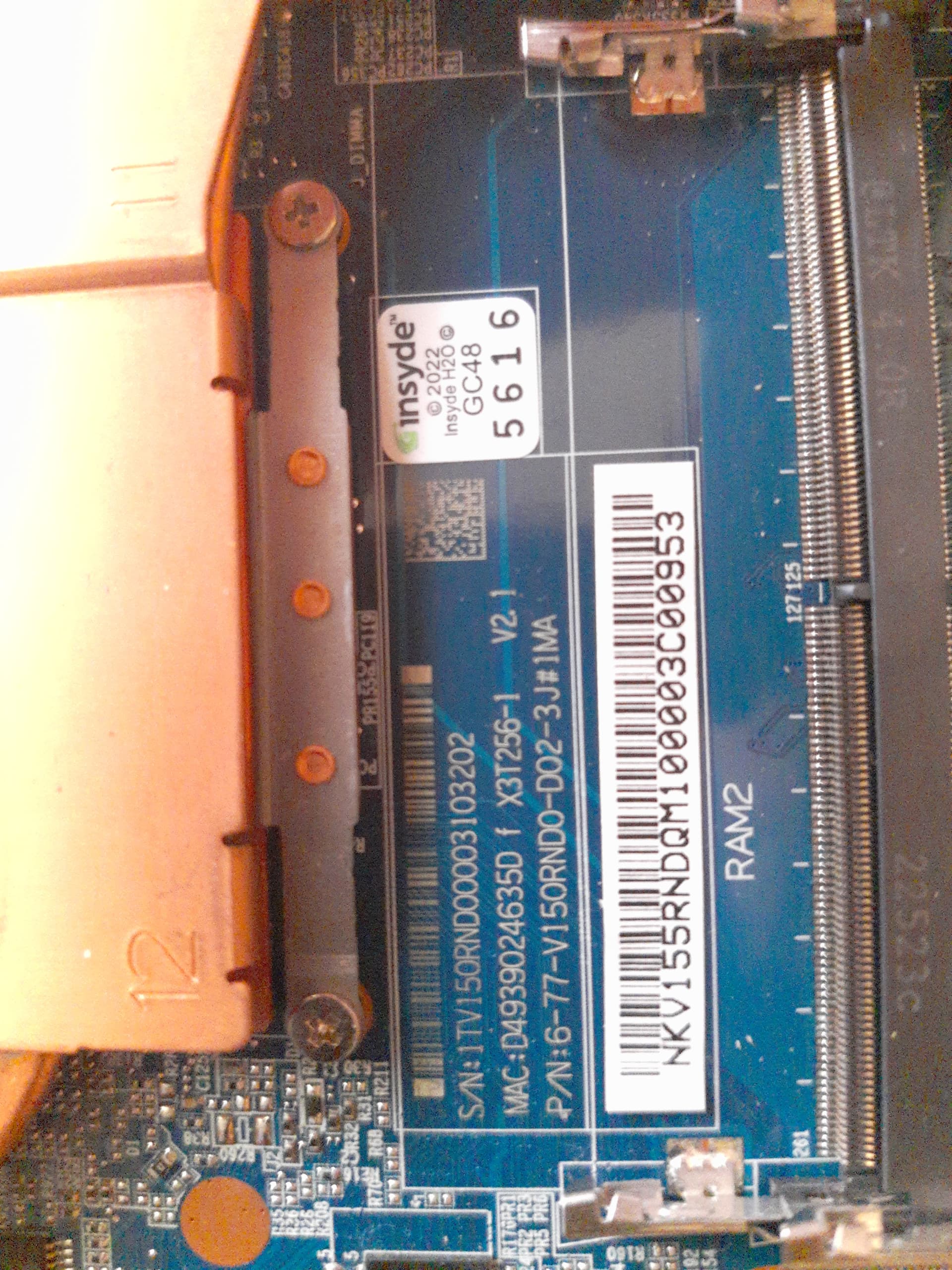

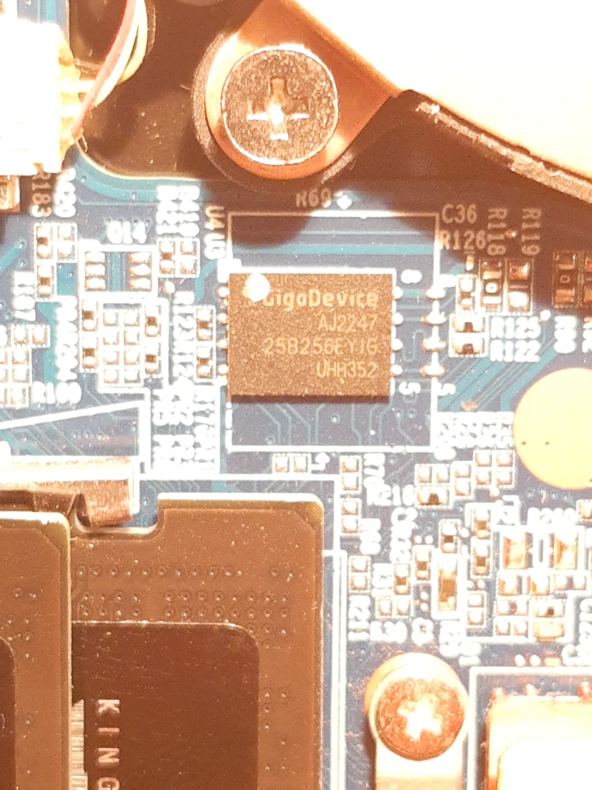

Share the readings of the ICs, 2 if not mistaken as this should be a 32Mb firmware or EC on the SOIC8 and bios+me on WSON8.
Provide the fowling: ProductNumber, SN, MSN, PCB P/N number
EDIT:
These are Clevo based systems, take out the DIMMs, it should be printed label on the pcb, under them, take a foto of it.
I have here a dump that seems correct for the system but i need to be sure and needs image re-contruction, thats why im asking this and dumps, i do not own such system to dump/share it directly.
…And i need the original ones… not the ones modded you ask here
The bios chip is a GigaDevice AJ2247 25B256EYIG UHH352.
and for my laptop :
Product Number : V155RND
SN : 230V155RNDQM1KAP2000733
MSN : 30035597
I don’t know what’s the PCB P/N number ?
Thank’s for you’re reply
I found it, thanks for the hint. It’s true that I asked on another forum to see if it was possible to have a modified bios but now I need original bios :).
So you didn’t backup before applying the attempted mod?
EDIT: Ok, ill try to provide you an image…need some time.
EDIT: Here, try this image, it’s still system data blank, you just need to confirm system recover, if ok i’ll try to add the data info.
I never got the bios modded but you’re right, and I made it clear in my first post, like a noobie I didn’t bios dump before.
Yes !!! thank you so much, you saved me, I was able to boot on windows without any problems and therefore get my pc back. Thank you so much.
