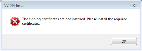

My GPU is TITAN Xp, I tried your files. Not working with The signing certificates are not installed hint. Can you make files for TITAN Xp? Thx very much.
Have you modified it with dartraiden’s files?
Yes.
Thx for your reply. It did’t work for me. Fresh Win7, may I install some updates First?
Have you tried installing as administrator?
I only installed the drivers after installed a set of complete updates for Windows 7.
I’ve tried with administrator again, same error.
Which update do you use? Maybe update issue.
I have ALL possible updates installed :sweat_smile:
It’s best if you check Dartraiden’s solution and let me know whether you encounter the same issue when trying to install his drivers, or if the installation goes through correctly.
