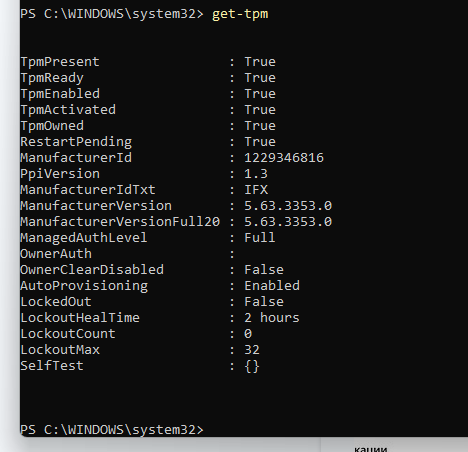

I don’t have a firmware folder.
Then no idea. Was this a screenshot for a single timepoint? Then all other windows show the old version?
What do the Powershell commands tell (Get-TPM for example?)
Powershell commands tell 5.63.3353.0. Probably a Windows 11 glitch

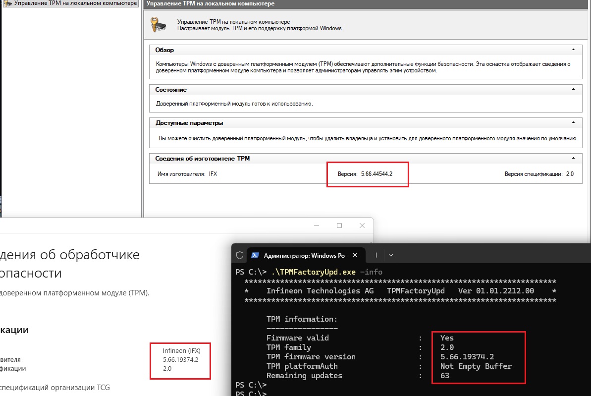

I don’t think you have version 5.63.6400.0. See my post above. Enter get-tpm in PowerShell.
When I enter get-TPM I indeed see version 5.63.3353.0 but in the console (tpm.msc) I see version ‘manufacturer version : 5.63.6400.0’ .
Windows 11 Prank
I have other data when I run ‘get-tpm’ Can I safely run the update from a USB stick ? There are 3 files in the folder . I would run the command : ‘TPMFactoryUpd -update tpm20-emptyplatformauth -firmware TPM20_5.63.3353.0_to_TPM20_5.66.19374.2.bin
