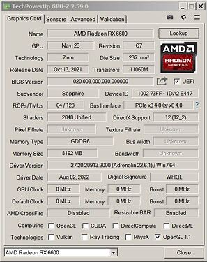

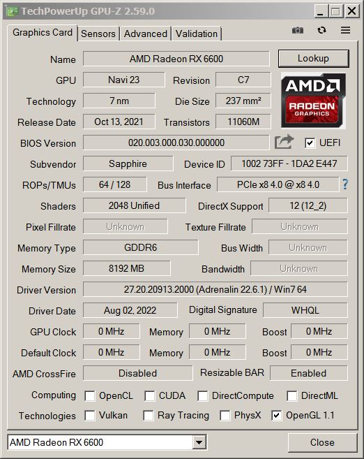

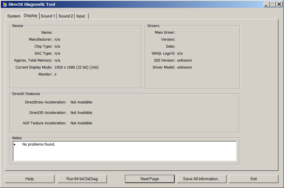

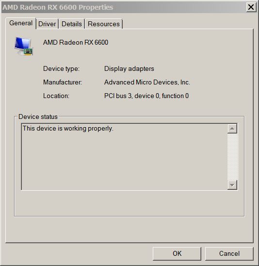

Driver Installed correctly in devices but not shown in dx11 dxdiag
but is correctly shown in GPUZ app
W7 fails to recognise the AMD GPU and uses the igpu with microsoft vga driver.

You should better check the HardwareIDs of the graphics adapter and do a Google Search for a Win7 supporting AMD driver.
Hi, the amd driver installed is the last legacy release for W7
Did try earlier releases but the same outcome.
The device Id for the 6600 gpu-
PCI\VEN_1002&DEV_73FF&SUBSYS_E4471DA2&REV_C7
Tried the amd igpu (Raphael) this is not recognised either
PCI\VEN_1002&DEV_164E&SUBSYS_7D761462&REV_C7
PCI\VEN_1002&DEV_164E&CC_0300
It seems for whatever reason W7 UEFI cannot recognise these gpu.
I recommend you to check the Device Manager. Check where is the monitor (if under RX6600 or other place). Check both adapters’ resource. Check PCI configuration space by RWEverything. The resizeable bar is also a possible reason.
