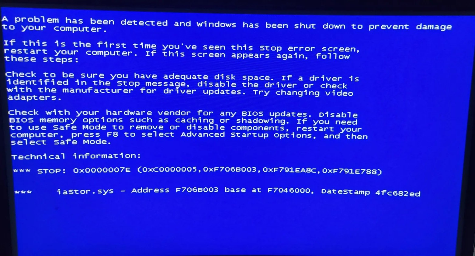

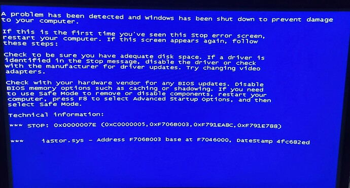

I’ve tried these drivers as well, specifically the “Classical” Intel RST AHCI/RAID drivers which gave me a blue screen with the stop code:
0x0000007E (0xC0000005, 0xF706B003, 0xF791EA8C, 0xF791E788)
iaStor.sys - Address F706B003 base at F7046000, DateStamp 4fc682ed

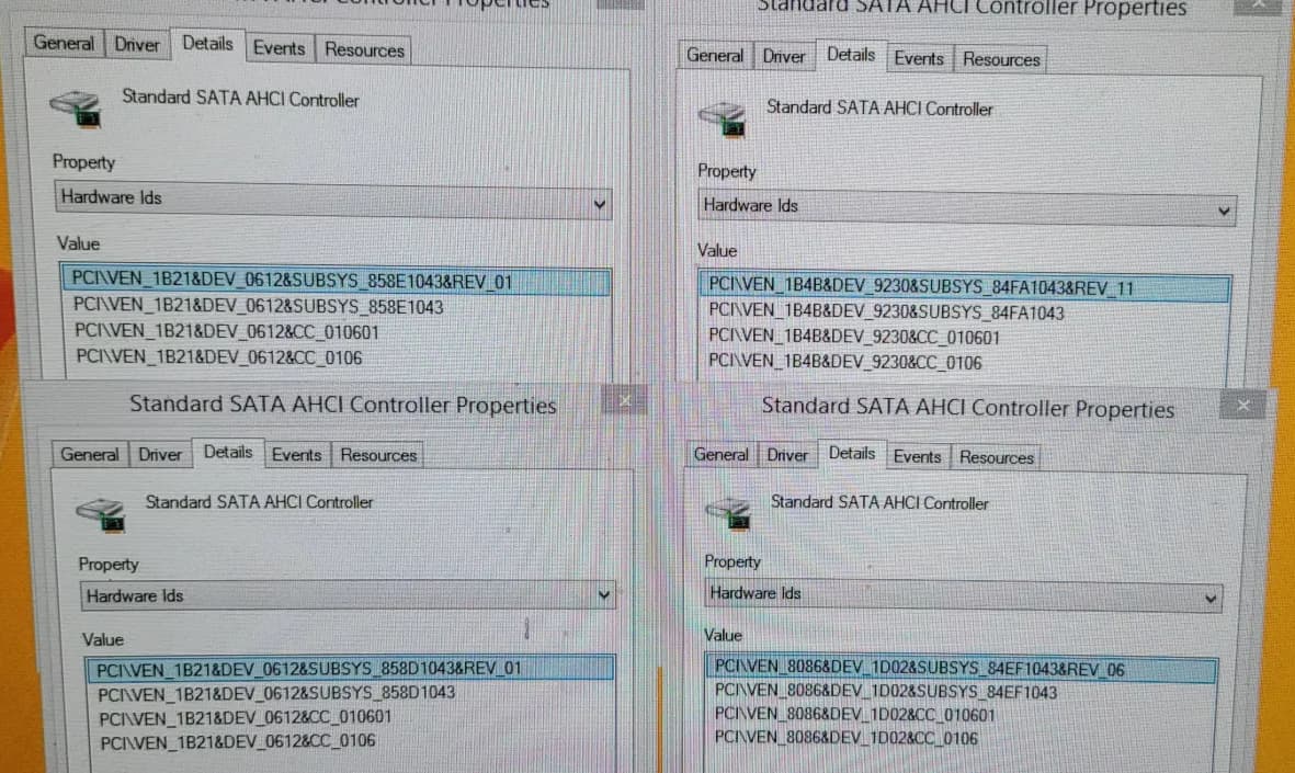

Hello, I have uploaded 3 images from device manager. I’ve also included the drivers and the ISO I tried. Let me know if anything else is needed. These pictures were taken on Windows 8.1 x64 running in AHCI mode.

Unfortunately I am still getting the 0x0000007E blue screen using “Generic 32bit Intel RST AHCI driver v11.2.0.1006 mod+signed by Fernando.” I’ve made sure to use an untouched WinXP SP3 x86 ISO. I am completely lost at this point.

As you can see here, your system has 4 different on-board SATA AHCI Controllers (2 ASMedia, 1 Marvell and 1 Intel):
Hello again, I’ve read through the article and it’s no help. I’ve tried “Universal 32bit Intel RST AHCI+RAID driver v11.2.0.1006 mod+signed by Fernando” and got the 0x0000007E bluescreen. I’ve also tried RAID mode with RAID drivers, same thing.
What I’ve noticed is when I plug my SSD into the Intel SATA port I get a 0x0000007B bluescreen no matter what. (with drivers, without drivers, AHCI mode, IDE mode, etc.) When I use the ASmedia ports I get the 0x0000007E bluescreen with your modded drivers.
