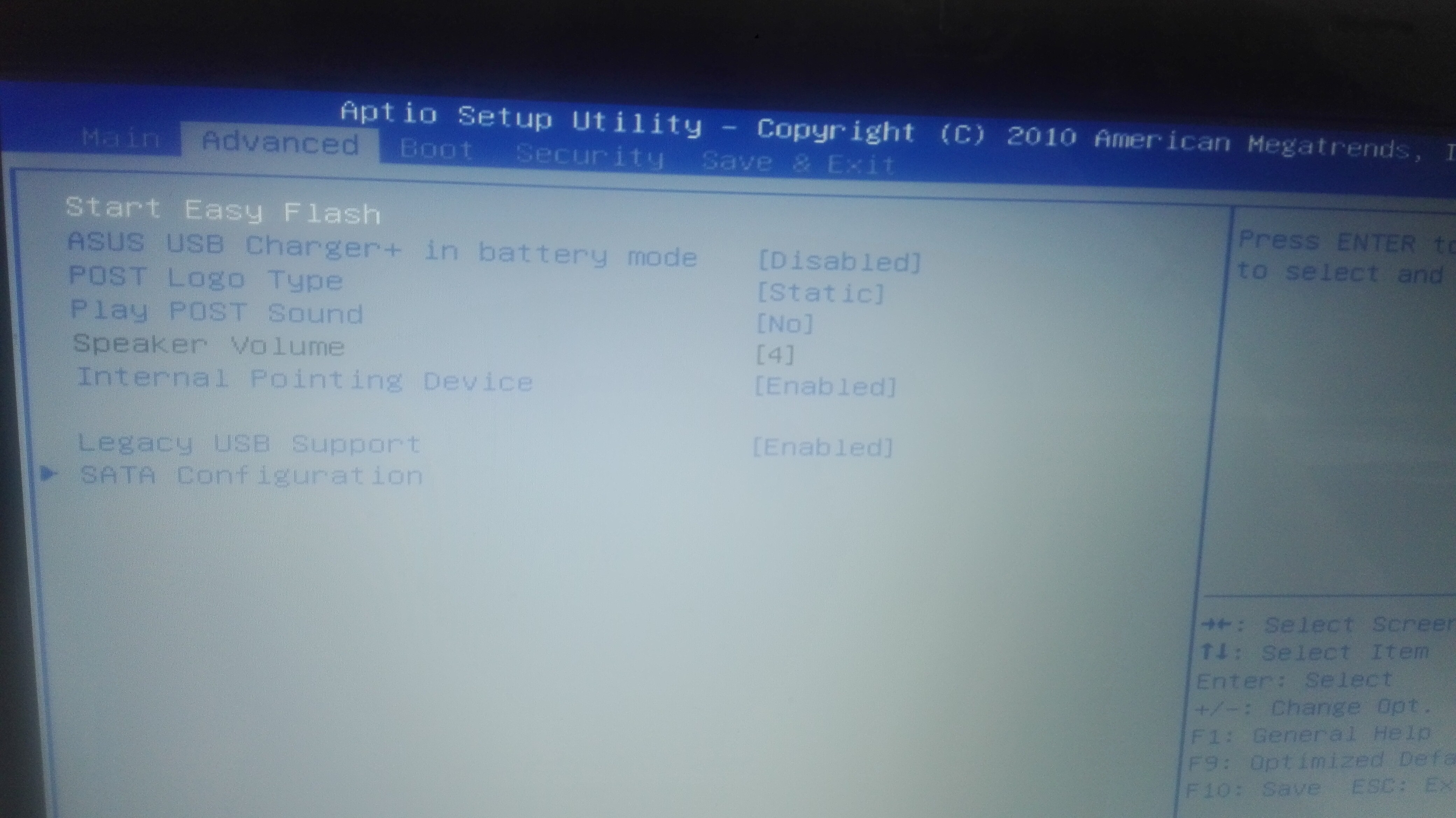

but after EZ flash as you see in the pictures two access level changed to one !!!
Oh my goooooooood you are amazing man you made it.
First I flashe ASUS K43TKB.206 with EZ flash and nothing happend but seccond I flashed ASUS K43TKBS.206 with EZ flash and look what did you done
Now please do the rest of It. the important part is in Chipeset menu
thank you very very very very very much
@Overlord - Yes, because you flashed stock BIOS with EZ Flash and BIOS went back to normal. I don’t know how you flashed mod BIOS, only you know, once you figure out for sure please let me know exactly what version tool/method you used so I can make a note of it for other users
Ohhh! OK, so this system is old enough that EZ Flash allows mod BIOS??? Looks like it, haven’t seen that in a while And thanks for the image, I did not intend to enable Advanced, only Second Security, so this is a good and bad thing, now I still need to figure out which is what because I thought I did hidden security not Advanced.
I can enable them all at once, but you don’t want a bunch of duplicates, that’s why I wanted to do one at a time and picked security since it was near end.
