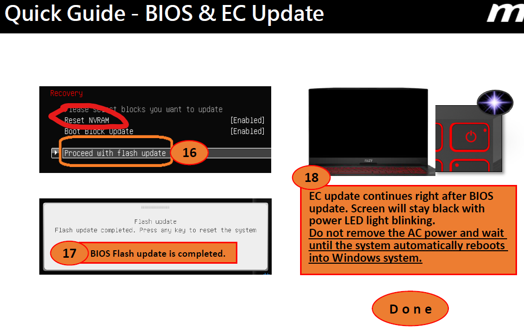

This should fix the issue…was it like this???
Read the pdf inside MSi bios update 117
Just wanted to clarify that I have already updated to BIOS version 117
The update process completed successfully without any errors, and the system is working normally in general.
However, the original issue still persists exactly as before — there was no change after the update.
Also, during the BIOS update process, there was no option related to NVRAM — I did not see any prompt or checkbox to preserve or reset NVRAM.
