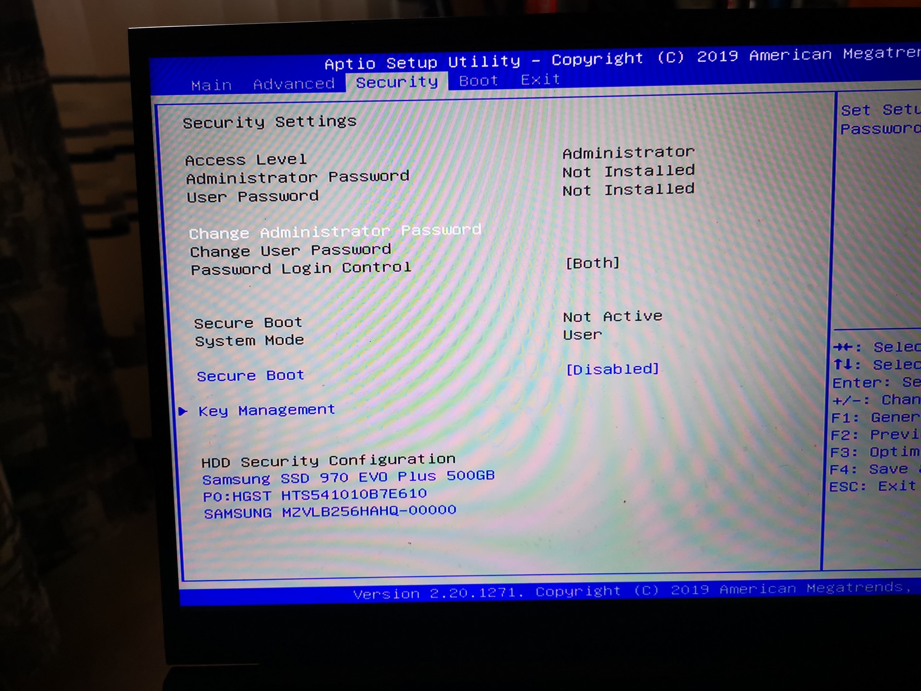

edit - @371 - Please make DOS Bootable USB, and disable secure boot in BIOS @ Security Page

tried 3 times all the same result, Secure Boot is disabled, somehow the ME version number is back again, but I noticed under Windows 10 the task "System" (ntoskrnl.exe) is constantly causing ~10% load, which leads to higher idle CPU package power consumption and 10°c temperature hotter, the CPU speed never goes below 3.8Ghz

@371 disable secure boot already? If yes, don’t use Rufus, make a Win98 SE disk instead, or don’t use MBR Rufus options, or don’t use UEFI Rufus options etc.
