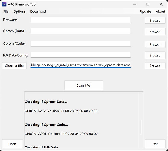

Just curious, I can’t find my hardware flasher so I am not going to attempt it anytime soon.
I have a NUC 12 Enthusiast with an A770M (Serpent Canyon), seems abandoned for dGPU firmware updates, it seems Intel never released a firmware update with its drivers, there was one beta driver that included a matching firmware.
ARC firmware consists of 4 individual firmwares\parts.
In ARC Firmware Tool, “firmware” and “oprom (code)” are universal as long as it matches SOC/GPU.
Both “oprom (data)” and “fw data/config” are customised per SKU\vendor.
Do you think cloneVBT might work for some ARC oprom-data files?
I have attached a zip of the source files and cloneVBT output.
My aim is to have all ARC related firmware on my system as up to date as possible, I have had experience of newer ARC firmware improving or fixing graphical issues like corruption and flickering on multiple systems.
I believe ARC firmware is more important than the usual vbios/gop, Intel does roll out firmware updates with their drivers after all, unfortunately some models/vendors get left behind.
