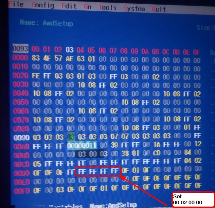

However, that guide shows you how to change something in “Setup” you wont be doing the change there, you will make change in “AMDSetup” GUID >> 3A997502-647A-4C82-998E-52EF9486A247
Go to offset 0x93 (93-96) (May be 0093), if default is now 2GB then you should see 0x93 set to either FF FF FF FF (Auto) or 00 08 00 00 00 (2GB)
You want to set this (93-96) to 00 02 00 00 = 512MB

I changed the value 0xd4 to 02 (look at the spoiler, I have such a value there, but nothing has changed, everything is also allocated 2 GB)
Show me that page, sounds like wrong area or wrong offset, or you do not have Secure Boot disabled.
I never mentioned 0xD0??? You’re going to brick the BIOS, don’t make changes when you don’t know what exactly you’re changing!
I gave the correct change value above for 512MB, 02 is part of that yes, but it’s not at 0xD0 (nothing here is) and it’s a 32bit value taking four spaces that need to be changed (some may not need changed, if already 00)
I was wrong, 0xd4, I edited the post
But I changed your variables and I also have 2 GB allocated
Ohh!!! Sorry, you are 100% correct! I looked up at question ID instead of varoffset when I was typing out that info for you!! OMG, sorry!
All is correct that I mentioned, except for >> 93-96 >> Should have been D4-D7 Sorry about that, and I just told you to be careful
Go to offset 0xD4 (D4-D7) (May be 00D4), if default is now 2GB then you should see 0xD4-D7 set to either FF FF FF FF (Auto) or 00 08 00 00 00 (2GB)
You want to set this (D4-D7) to 00 02 00 00 = 512MB
If you see 03’s as you mentioned, then it may not be correct varstore you are in, or secure boot enabled etc, show me image
@Lost_N_BIOS
The value 0xd4 is shown by FF (auto)
How can I change it correctly so that 512 MB is allocated?
thanks
Edit: is photo http://s000.tinyupload.com/index.php?fil…771926419876261
The offset for 0xD4 is not the only one that this setting fills, it’s 4 bytes in total length as I mentioned
0xD4 - 0xD7 >> If >> FF FF FF FF (Auto) or 00 08 00 00 00 (2GB) >> Change to >> 00 02 00 00 = 512MB
