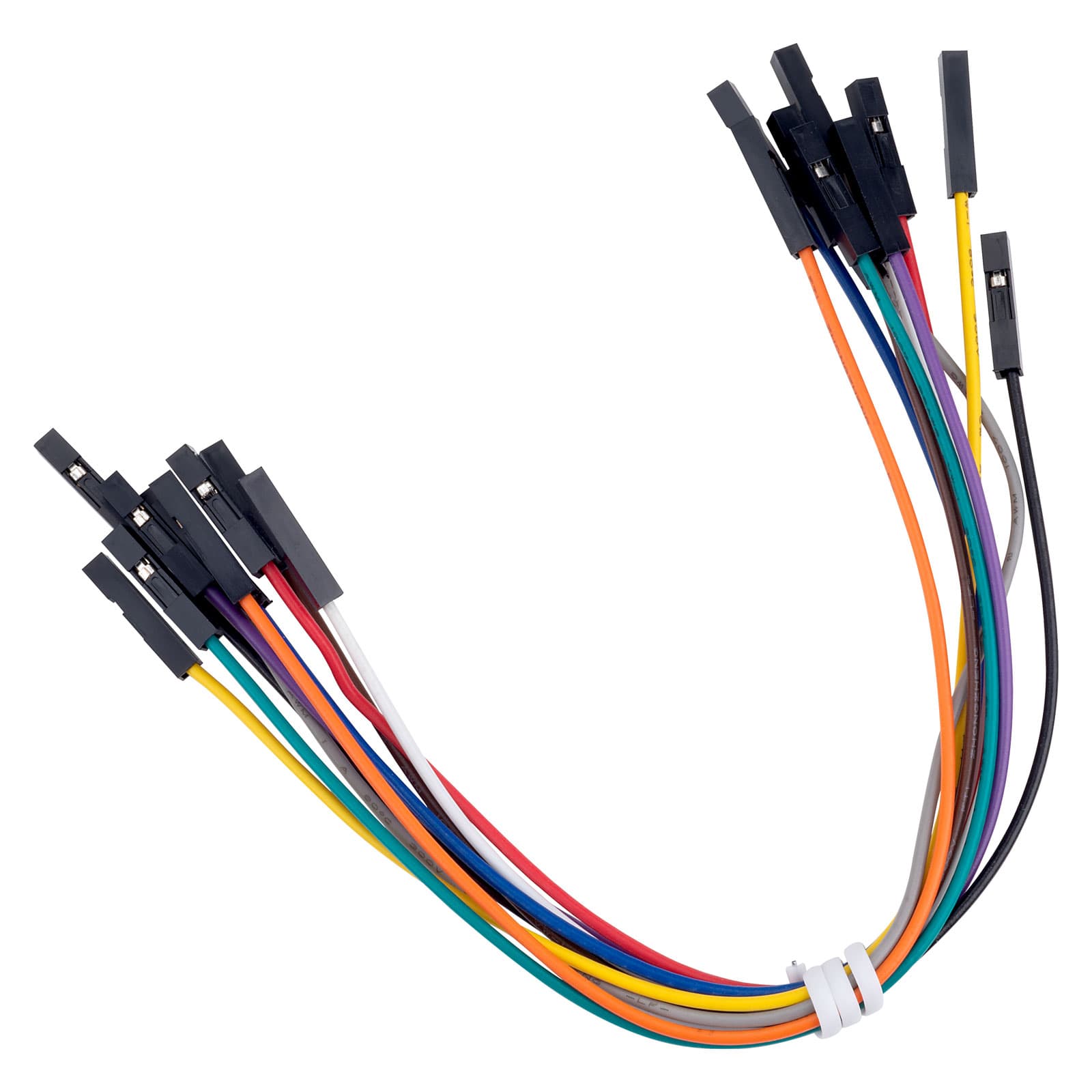

Now the “part talking” of “expensive” im really not following you here… the header is already on the motherboard, you just need to purchase some “Dupont” cables pitch 2.0/2.5… and those are very cheap.
Dont ask me the header pins connections…search for it on the forum or web.
