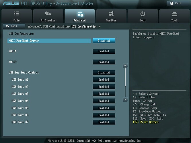

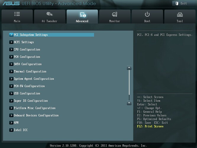

- Enabled all advanced settings (be careful with what you do, some might damage your hardware)

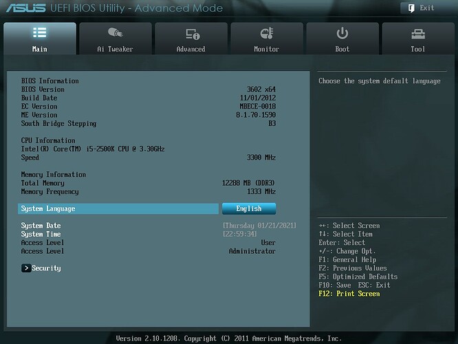

- Management Engine updated to 8.1.70.1590

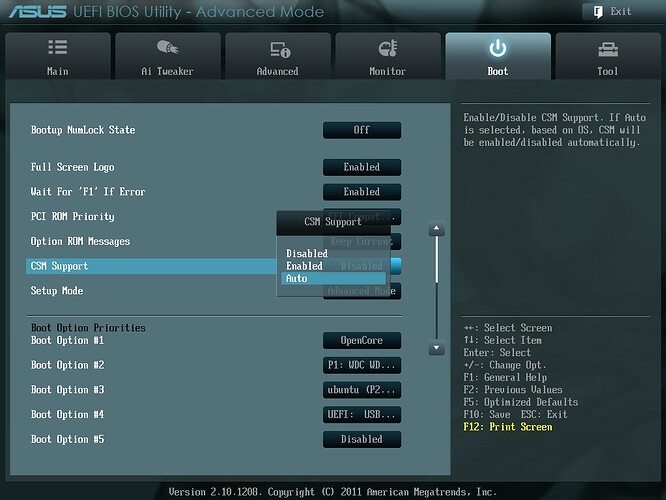

After replacing CSMVideo with HermitCSM (thanks to Hermit Crab Labs for the driver), the CSM module still gets loaded but at least it doesn’t prevent GOP from working.

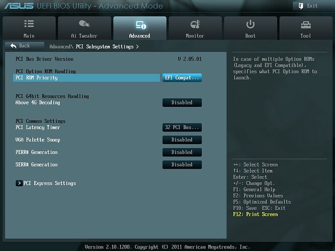

To enable GOP you just need to set "PCI ROM Priority" to "EFI compatible" in "Boot" pane.
It is highly recommended that you disable OPROMs as they seem to interfere with logo display either by making it not appear or appear corrupt.

About "Above 4G decoding" :
You must pay special attention to the status of \ Advanced \ PCI Subsystem Settings \ Above 4G decoding, whether you use legacy or GOP display init.
- Above 4G decoding must be disabled when running display in legacy mode
- Above 4G decoding must be enabled when running display in GOP mode
Other combinations will result in getting video signal with black screen and no POST.
Those results were obtained using RX580 on PCIEX16_1 and RX560 PCIEX16_2, your mileage may vary depending on your configuration, in case of problem use the reset CMOS jumper to get back to bootable state.

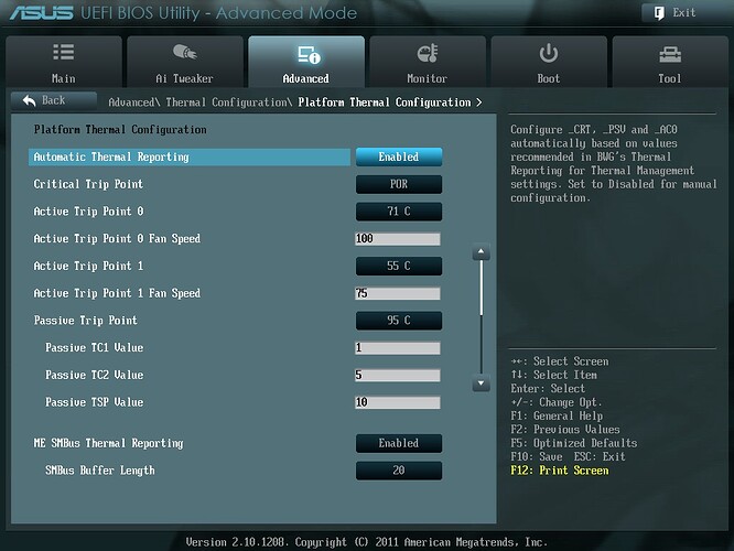

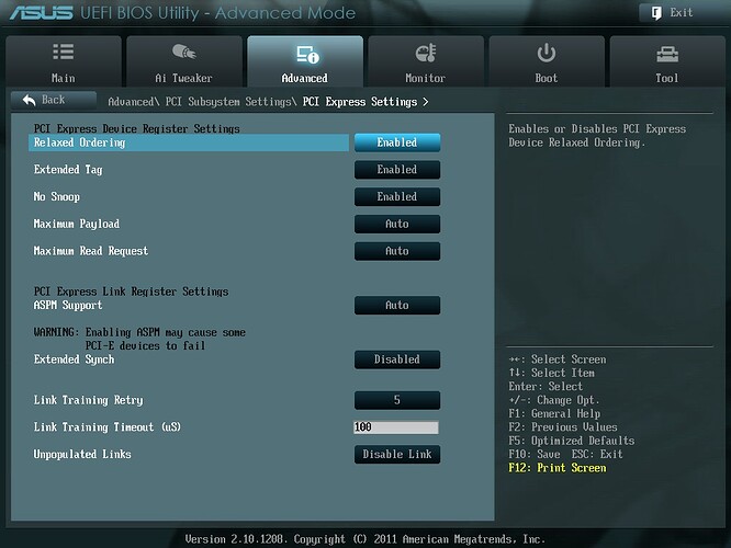

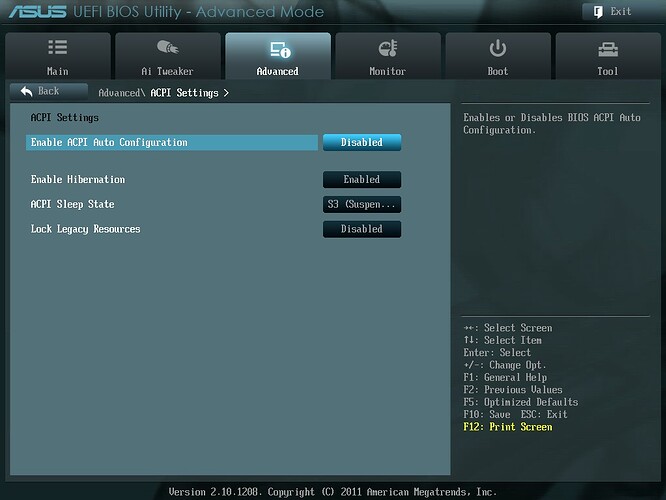

About the many new options :
You’ll see there are tons of options. So far, the options I tried run fairly well and do work, but I’m far from having tested them all, if you notice something that doesn’t work, or is irrelevant for this mobo, please report.
Some irrelevant settings were left disabled (not working or intended to absent devices like integrated GPU or battery…)

Some screenshots (there might be little differences here and there, not all are up to date)
