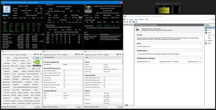

*Screenshot credit to @AllenR.

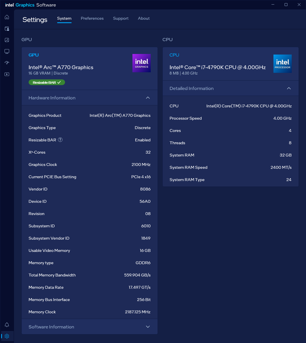

**This is a small update from @FPSUsername bios, with now ResizableBar working at full 39 Bit Address instead limited for some time ago.
How To Enable Resizable Bar
  • Normal Resizable Bar: Use ReBarSate from here, And Run as Admin.
  • Nvidia Turing (GTX 1600/RTX 2000): Use this, And Run as Admin.
You need to enable Above 4G Decoding for Resizable Bar and Disable CSM/Legacy (boot to UEFI only). To enable it, go to bios → Boot → Above 4G Decoding and enable it.

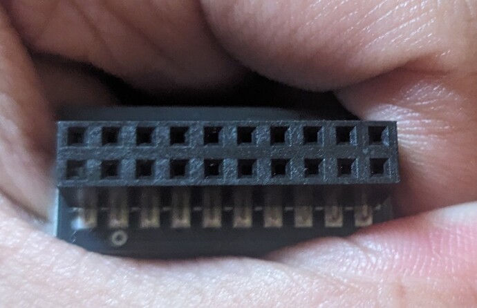

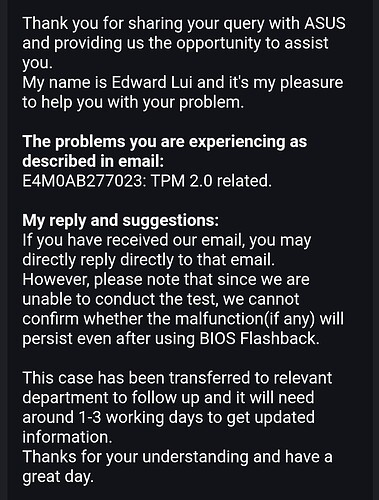

Hello @AllenR, so i’ve persuaded asus support team for M7R, and the Asus HK Rep said that they’re willing to make 1, but it wont be tested on their side since they said they don’t have the system, i agreed and am waiting for their result. Are you willing to test if you have the Asus TPM-L R2.0 module (or known compatible), since i don’t have the tpm module (and it’s hard to find 1 in my country)?
Here’s my last convo of the email:

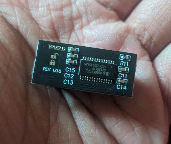

Found a cheap one. Dunno if it’ll work with this BIOS update tho, since it’s not an official one. The reviews only show it working on Gigabyte boards [ga-b85m-d3h & ga-b150m-d3h], dunno about Asus ones.
Asus still hasn’t provide me with the bios yet cuz they kept asking for the tpm slot and the tpm module photos… like literally everything is in their own support page and clearly said :rofl:.
I did gave the support aome photos, hoping that it’s ready…
Gigabyte eSupport never asked me for any details like photo or what module, they just… immidiately work at the request, and delivered it flawlessly :rofl::rofl:
Damn, I guess they don’t trust their customers lol.
”Gotta make sure they don’t have a fake VII Ranger” or something like that. (dunno)

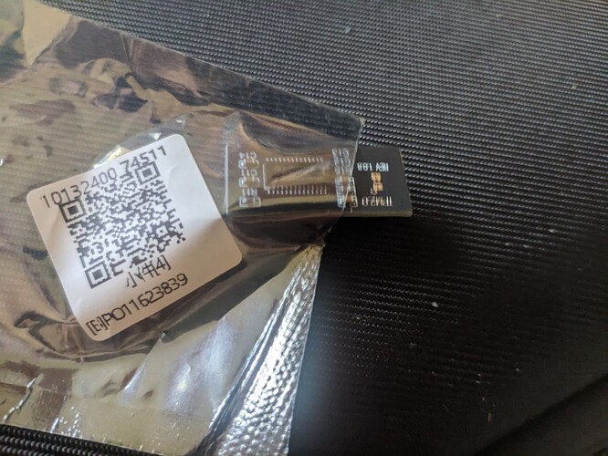

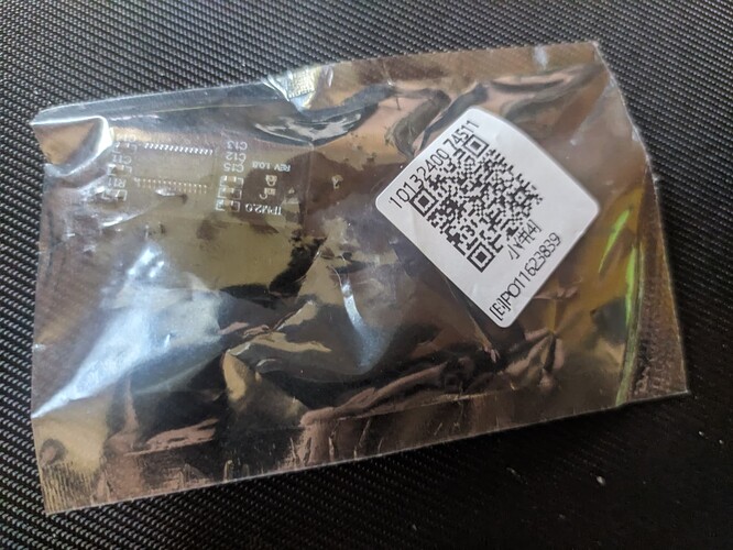

For me, the module might arrive next week. It’s just a cheap one tho.

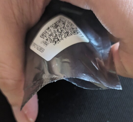

Wait, for the TPM Module photos, did you just provide one from online?
Do I need to match that one?
Also, would there be an option to swap between the Old and Current ROG Splash logo?
Man, it’s not even well-sealed lol. But it’s here now.
Asus hasn’t replied me yet for the bios, still working on it last mail they sent me yesterday

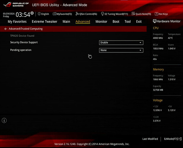

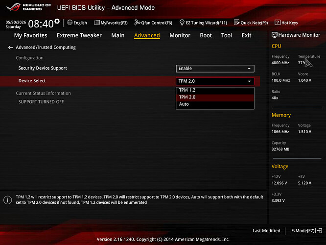

Changelog 30.05.2026
  • ASUS Support Team has sent me bios 9901 with TPM 2.0 Support.
User @AllenR Has managed test it and update his module firmware, it worked fine like usual:
