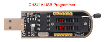

BIOS is working I’ve flashed it via CH341A.
I’ve used steps from these threads :
(check any youtube video before - remove battery first from MB and then ā€œBIOSā€ chip from MB) and put it into socket on CH341A.
Don’t forget extract cap file into bin via UEFI Tool (i’ve used 0.28.0)
( used - Step 4 - Installation of Win10/11 onto the NVMe SSD)

Hi All
I’m trying to figure out/piece together the guide for flashing Hans Custom BIOS/UEFI - to Winbond W25Q64FV chip via the CH341A for the Asus Z9PE-D8 WS as provided above.
I have some Winbond W25Q64FVAIG chips on route that are apparently the same as Winbond W25Q64FV according to ChatGTP & Perplexity as did not want to mess up the original chip just incase.
Is there anything missing/needs amending below? query in step 05
  1. Power off mains to Motherboard
  2. Remove CMOS battery from MB
  3. Remove BIOS chip from MB (observe/log chip dot location)
  4. Place Winbond W25Q64FV chip in CH341A programmer socket (diagram inc chip dot placement in tool app)
  5. Extract cap file into bin via UEFI Tool 0.2.8.0
    (extract as is or extract body? Z9PED8WS.bin)
  6. Install CH341A drivers from CH341PAR.exe
  7. Connect the test clip to BIOS chip.
  8. Connect CH134A programmer to USB.
  9. Run CH341A_c.exe from CH341A program v1.29 folder.
  10. Go to ā€œAutoā€ and uncheck ā€œEraseā€ and ā€œBlankā€
  11. File/Open Z9PED8WS.bin
  12. Operate/flash
Edit just found this great illustrated guide Do our none soldered BIOS chips fit staight into the CH341A socket?
Please read posts #2 for traditional Asus methods and guidance of post #3 using CH341A
The IC seems to be a DIP8, meaning it can be plugged directly in the programmer.
