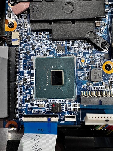

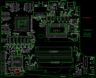

Show me the ICS you’re messing with…
SPI main IC including EC 128k on it, not separated IC, if the EC controller is damaged it needs Professional intervention, not you for sure.

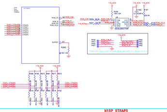

U8 is vbios…not to program with any EC whatsoever data…
You already shared that material, that’s not what im asking to point out…
Also, the files PCS provided will never boot, it lacks the CSME region.
Look at the EC code present @ main bios SPI data:
So no way a dedicated IC for it and lije the conclusion on Badcaps, you were messing with NV vbios.
