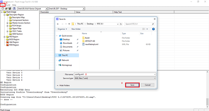

6. Go to "File > Save As" and save the configuration xml file, in this case it's named "config.xml". Afterwards, close the FITC window.
7. At the FITC folder there should now be a folder named after the inputted file, in this case it's named "Z97OCF1.80". Enter "Decomp" subfolder. There should be a number of files there (BIOS Region, Flash Descriptor, OEM Region etc) including a "ME Region.bin" or "TXE Region.bin" file. Take the previous "ME Region.bin" or "TXE Region.bin" file you saved at step 4 and copy it where the current "ME Region.bin" or "TXE Region.bin" file is, effectively replacing it.

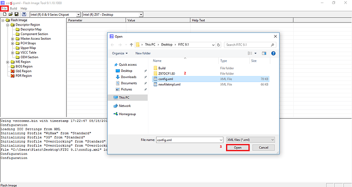

8. Run FITC again. From "File > Open" select the saved configuration xml file from step 6 and open it.
9. Click the "Build Image" icon (or "Build > Build Image") and it should complete successfully.
