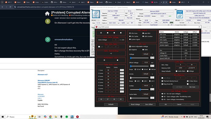

Thanks for your reply! Yes, I did the same thing on my old Del 7567, replacing the Recovery BIOS file with the old BIOS version via the console in Windows and running the recovery. But on this Alienware, the problem is that the recovery doesn’t start at all. Or it starts but without the charger and restores version 2.18, even if there was a different one before.
A couple of days ago, I found a way to unlock the voltage on version 2.21.1 using the guide brendangreenley site. The essence is to search the BIOS code (dump) for a line with voltage locking and disable it in the GRAB command line (0x1 to 0x0) in UEFI mode from a flash drive before Windows initialization.
