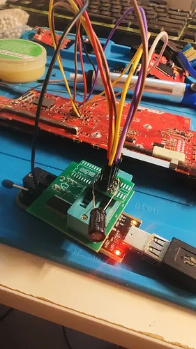

ch341a > 1.8v adapter > cheap wires about ~12cm
(Curious can i just use it without adapter or immediate fry..?)

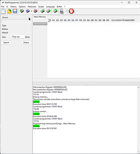

Neoprogrammer
connection is decent and minimal resistance I think
This guy here:
video managed to get it reading fine by bumping voltage to 2v, i want to know whats the logic behind this/how this worked? In his video he was missing a pullup resistor though, as far as i know I put the resistor back and tested it, all good.
I didn’t write/flash anything yet, only read. Anyway i updated bios via asus EZ flash 3, same results. I’m also in a pickle, as I can’t write my custom bios or anything to the chip because verification keeps failing for some reason I can’t seem to figure out, its been 5 hours of searching and i’m at a dead end.

Hi, I know some 1.8V chips need to be desoldered to be read or written (due to in-circuit programming protection, the chip needs to be fully isolated, actually its Vcc track). But I don’t think your chip is one of those. Also, since you’re not comfortable with a heat gun yet, I wouldn’t recommend going that route anyway, and yes, applying 3.3V to a 1.8V chip can damage it.
As for programmers, I don’t have much experience with the CH341A. I’ve never really used it (not a fan). I started a long time ago with the MiniPro. Honestly, I think your chip would read just fine with the XGECUs, RT809F/H, etc. But you can still try with CH341A, just make sure to go through the 3 guides already available on the forum, they might help clarify things. 1, 2, 3.

Today I got very lucky and managed to make a successful flash of my unlocked edited bios, or so i thought
The chip wrote fine and everything, the device turned on, components are ok. but bios is my main problem here
What i did:
Grab stock bios file from asus website, put it into UEFI Editor tool, unsupressed all options, changed access level to 09 for all items, and then directly flashed it to the chip. The unlocked file was flashed correctly, passed verification.

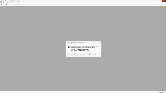

eg for my asus b560m plus wifi, I used AMIBCP instead, manually changed all values to “USER” and they showed up just fine, still running this version no issues.
AMIBCP however did not work on this asus rog ally bios, and crashed, hence i used UEFI Tool

For anyone flashing this device, adding a 50uf capacitor to VCC and GND helped stop the false reads/writes.
Consumes ~70-80mAh because of other components.
Careful when soldering, can knock off some components because they’re really close.
Also ensure a very good connection with the wires if you’re soldering.
Neoprogrammer did the job but SOME VERSIONS ARE RATTED

I’m curious though is there a guide on unlocking hidden bios settings on 32mb bios? Most of the useful settings are missing, AMIBCP seems to crash when loading it in. Also if you know some guides, please send them. I also have no clue how to fill DMI data without AMIBCP..
