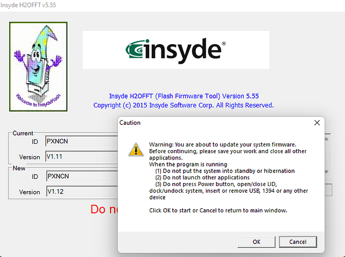

When I click OK the system reboots and the flashing process starts, but I get this Invalid firmware image error instead.

deleted. Download this archive containing H2OFFT and run the program. If the BIOS installation does not start, and H2OFFT closes without any message, then there is no sense to run it again. If, nevertheless, it will throw an error message, then please write what exactly it says.
there is no error it asks if I want to continue flashing it or not,
Do you want me to continue?
Yes. You may continue. This is not a modified BIOS, so if it is installed nothing should change.
