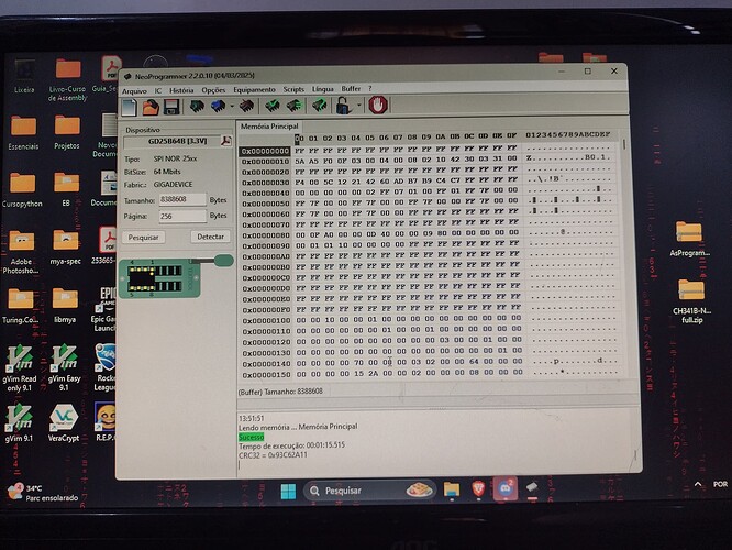

The EPROM has arrived, I’ll try to re-record the BIOS today, after work, send your test files again so I can be sure of what to test later.
here.
Looking forward to you unlocking this thing and having a method for this types of BIOS, I was going to risk it first but since you can now recover with a programmer that I don’t have I decided to wait.
@Sweet_Kitten Is this a bios file? I took it from what is currently written on the chip, I have doubts if this is really the bios chip…
idontknow.rar (5.5 MB)
Yes, this is the right one.
@Sweet_Kitten Okay, I’ll write the dump.bin to the chip, okay?
Up to you. You can write the file I posted, or try fixing the dump on your own.
Dump.bin is the backup I made before modifying the BIOS.
Didn’t know you did that. I only recall the region.bin file.
Go ahead then.

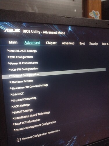

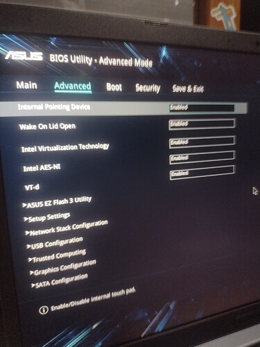

Yes guysq For a second I had a heart attack, even though the BIOS was rewritten (it was RAM memory, and it worked The re-recording, but I haven’t tested other files yet…)
@genius239 Your mod worked, what did you do???
@Sweet_Kitten
Your mod doesn’t, but how did Genius manage it?
I think he changed that…
