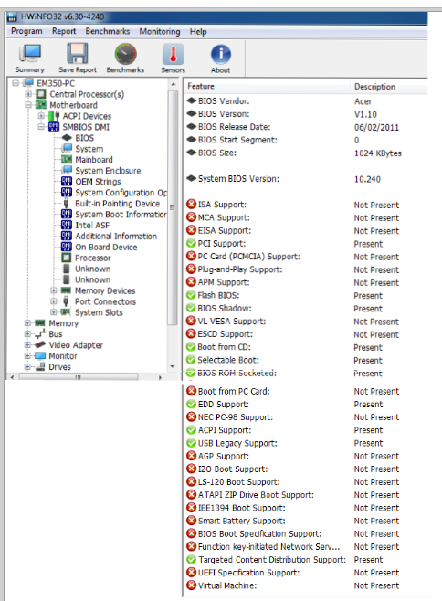

The eMachines EM350 uses InsydeH20 v.3.5 1.10 BIOS, which is locked and needs to be unlocked to be able to get running on full power. As an example, the Video Ram is set (and locked) to 8MB only!
If possible the features for at least Plug-and-Play Support, Virtual Machine, and maybe some other should be enabled too! Look at the picture of BIOS Features.

of HWinfo Main Page: https://i.postimg.cc/sXqMJb7Y/Main-Off-16.png
of HWinfo Mainboard Page: https://i.postimg.cc/xTKXKxCm/Main-Off-17.png
of HWinfo BIOS Features: https://i.postimg.cc/c4DV5ZrG/Main-Off-18.png
