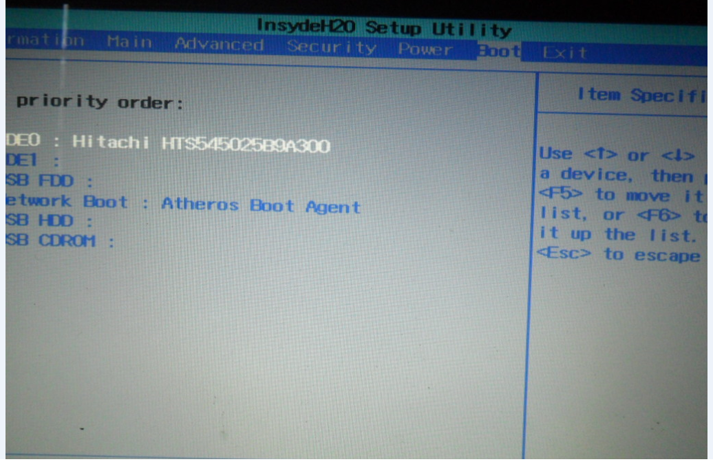

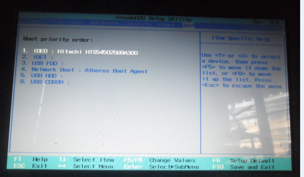

I’ve no problems to see the Boot Menu! That was only on the first test BIOS the fact. Please take a look at these 3 pictures: https://i.postimg.cc/26gDQ9rZ/Main-Off-20.png, https://i.postimg.cc/nr7t0Khw/Main-Off-21.png, https://i.postimg.cc/VLQw5h7y/Main-Off-22.png
The last 3 builds of the BIOS didn’t have any problems like the first build had!

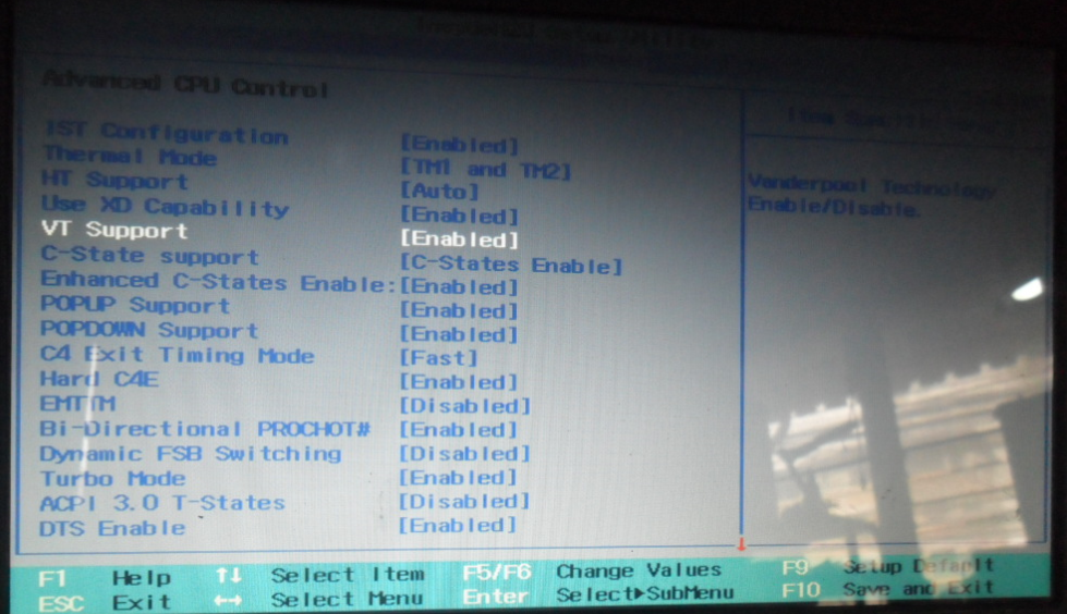

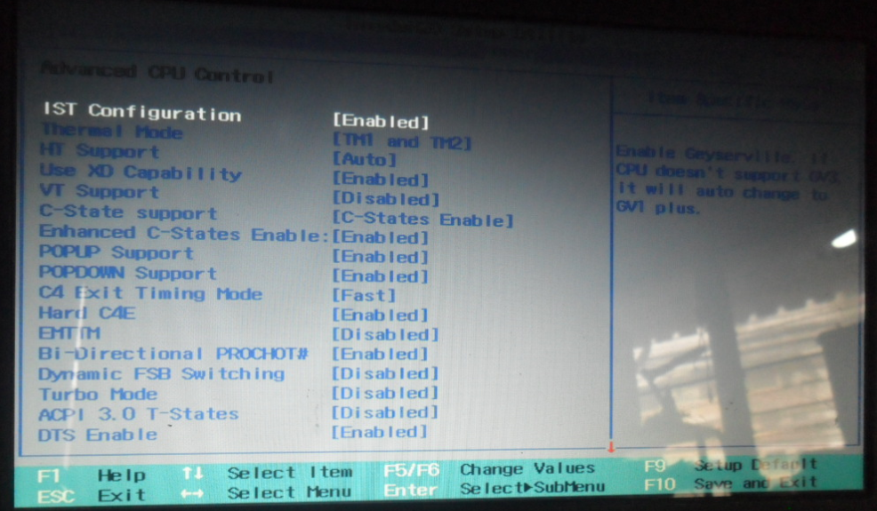

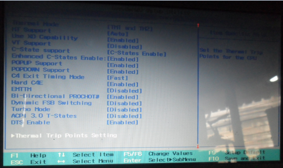

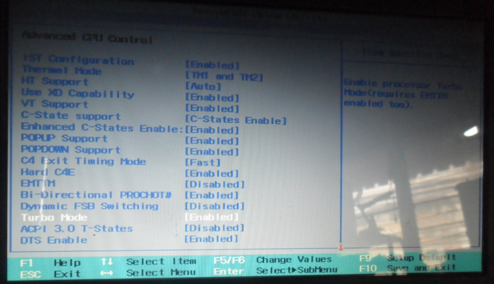

@Quaxth - Here, mid-way done test needed, please show me root of Advanced, and also show me inside “Advanced CPU Control” (Top to bottom, may need two images)
Some of this stuff we are enabling, may not apply to your CPU (such as “Turbo” or “VT”), I am not sure outcome if you enable some setting like that?

Oops! Just after restarting that machine again into the BIOS, I saw that the Video Memory in Main Menue is gone fully. In the same Menue, now are CPU Type: [Not Detected], System Bus Speed: 667 MHz, System Memory Speed: 667 MHz, all 3 blacked out.
Advanced Menue had a lot changed now too!
In Security Menu: EVERYTHING is blacked out, could even not set any password!
In Power Menue: except for CPU Control, everything is the same (normal).
In Boot Menu: same new entrees.
All that is looking very good and easier to use.
Thanks a lot. If you need more pictures, please let me know.

Security menu, I have not touched, that’s how it is on stock BIOS. I only edited so far, the things I asked you, nothing else, so no need to look at anything else * Edit - sorry, I forgot I did boot already
OK, thanks for the images, I will let you know if I need anything else
* Edit - Thanks, these images told me what I needed to know for now! Except I need to see the CPU-z images I asked about above
If Bus speed and memory speed are correct, I still may remove all that, since CPU type is not detected properly, these are all tied into one combo suppression item.
I could maybe hide one but not the others, but I don’t want to risk that kind of edit on this BIOS without you having programmer in hand, backup made, and are ready to recover in case it bricks.
* Edit - I see what happened on the video, well at least the hidden one. Not sure why the original one disappeared, but I will put them both back now
* Edit - @Quaxth - Here, please test and confirm, both video back to normal now?

Thanks for the images, I will check. I will put video back how it was when I first changed it for you, if it’s not now (That is the desired goal)
Security I have not touched yet, I will make it all available to you But, trust me, you do not want to set a BIOS password, it’s only asking for trouble down the road!
OK, I checked the images, I see FBS 667, and memory speed 667 too, so at least those are correct. Do you want me to leave that in the BIOS main page at top, or remove it all, since CPU detection isn’t working correctly?
And, I see video is still not back to proper!! I’ll put it back to that first way I edited first time, and remove this detection (maybe this is causing the issue, not sure, and you’d have to test 2-3 more BIOS for us to find out)
Here, please show me BIOS Main image again now, so I can see what video looks like, if you can see both again - This has nothing to do with video anywhere except "Main"
http://s000.tinyupload.com/index.php?fil…289484884471267
But, as you can see now, in that Advanced >> Video, you can change DVMT size, this is the dedicated video memory you wanted, more-so than the 1/8MB thing.
On this, can you set 384 as max now, or only 256? If only 256, I will change

Regarding the Security Menue: on original all was able to set for Supervisor and User, HDD was frozen. Power On Password was disabled and that’s ok! And so it should be back! In this latest BIOS, #7, Supervisor, and IDE0 Hdd Password could be set, while User Password is blacked out. That could be OK, just the IDE0 HDD Password should be frozen. The reason for being able to set some password is easy: think about who’s using that machine in General: Kids! And Kids like playing with things around! So the Bios should be protected!
Regarding the Video Ram: the CPU and the Video Chipset can work with up to 256MB, which means 384MB will anyway not work! Leave it to 128MB and 256MB, please.

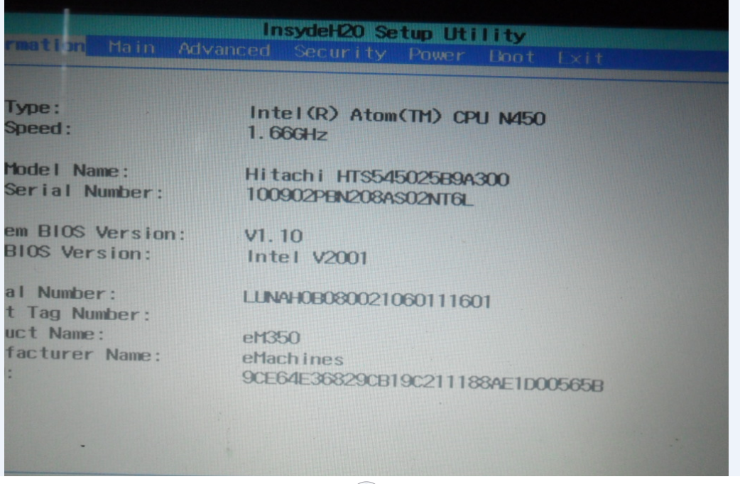

Please show me image of BIOS Main page, after flashing BIOS at post #29, thanks
There no next owner! I’m the only person who has the power of doing anything on the machines I gave to the school! If there would be anything the school has to give back them to me! Let say it this way: The school used those machines for free as long as they want and/or need. They are didn’t pay any Satang (Cent) for the machines, neither software, service, or whatsoever!
OK, here 2 pics: http://s000.tinyupload.com/index.php?fil…123257981793353 about the Information and Main. Need anything more?
