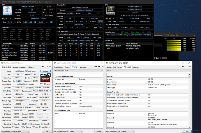

To enable rebar, you can refer to this post. Also for the updated modules, they’re updated with the version i did with the Sabertooth X79 in the post, and added nvme boot capability. In addition to the modded bios, i replaced the old ROG logo with Modern ROG one, also increased the MMIOH Size to 128GiB from stock 64GiB.
If bios is succesfully flashed, you could boot to bios, and when you disable CSM and enable Above 4G Decoding, the bios have no quirks whatsoever (XMP and OC you did working as-is stock bios), and ReBar working (just set rebarstate at 32 and reboot), could you please take a scrrenshot similiar to this:
BIOS works, and can get a screen shot. Is it possible you can also unlock the “Trusted Computing” menu under Advanced? This motherboard supports TPM 1.2, but it looks like the menu isn’t exposed.
