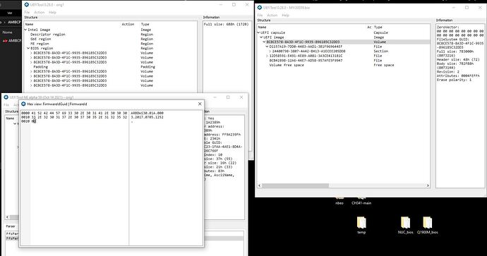

The Bios saved from NUC board is ARBDWi… and from Intel the last update is MYi30059.bio
Intel Nuc bio files don’t contain a firmware image, they are more like a building kit for a bios, but they contain everything that is needed to construct a firmware image- one has to combine the different regions and the UEFI volumes to a firmware image.
So that means I have to "build " a bios firmware from the intel bios file, there is some tuturial or guide that I can see ?
Thank you
Intel NUC7i7DNH2E BIOS to flash with hardware Just for the structure. That’s for another model, but the bio file you mentioned looks quite similar.
And you might be missing a new GbE but possibly the old one will be fine. There should be a configured ME within the bio- file- compare settings stored in FD/MD for old and new image in FIT.
Another way would be to look for a dump someone posted somewhere…

I have it working now after some hours of work
I will attach the bios file if someone needs or have some bricked MYBE board
