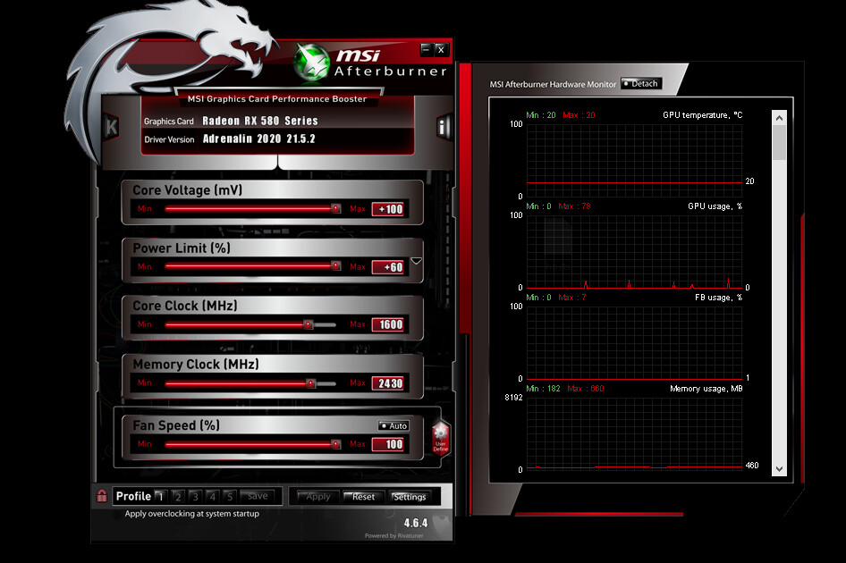

I have much expirience with the RX580, if you can tell me which card it is exactly I can make a custom bios for you, or guide you into making you’re own vbios. I with my XFX RX580 GTS XXX was pushing WR on air cooling. But something went wrong with the card and it doesn’t boot as it use to, and also I lost the heatsink screws…
1600mhz core
2430mhz mem
1000w vbios
I can’t find any other old screenshot of the power draw and voltage rails.
