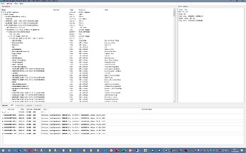

Take a stock bios update
Remove the capsule (0x0 - 0x1000) (UEFIToolNE or HxD)
That should give you a file exactly 16.777.216 bytes
Expand 4F1C52D3-D824-4D2A-A2F0-EC40C23C5916
Expand 9E21FD93-9C72-4C15-8C4B-E77F1DB2D792
Expand all down to 5C60F367-A505-419A-859E-2A4FF6CA6FE5
Go to 63F23E9D-5FDA-415E-9C2A-64C4E2A6ECE8 Freeform
Expand
Extraxt body from Raw section
Should give you exactly a file 8.388.608 bytes
Put this file before the bios update file without capsule (HxD) and you got a 24 MB complete image
(Make a backup of your own spi before flashing anything!)
(Bios region might get changed under an update, since the compressed FD and ME isn’t found in dumps)
(You might loose som board specific data like serial, mac)
If unsure post your results for check…
