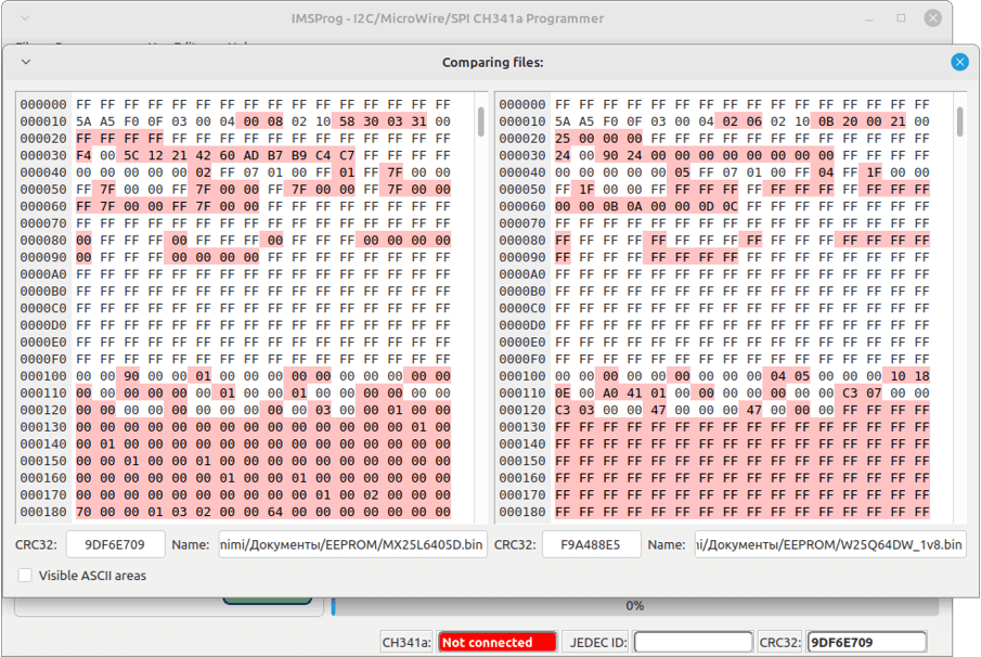

  • Ver. 1.6.1 - New feature: compare files. New feature: fill test array. Fix: when the page size is changed, the buffer is cleared. Fix: the code is executed twice and the code slows down the display of the interface.

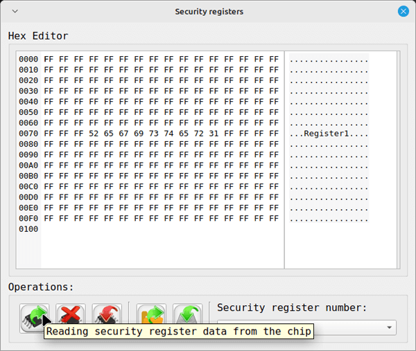

  • Ver. 1.5.1 - Fix: Incorrect install dir for udev while cross compiling. Added: Form for working with security registers for SPI NOR flash memory chips.
