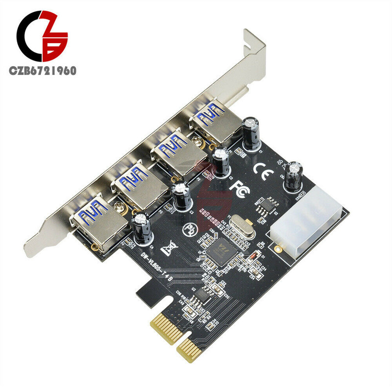

I have a PCI-e Card 4-ports (VIA VL 805) With code 10 error.

I think it is a generic one.
https://www.ebay.com/itm/4-Port-5-Gbps-S…oQAAOSw-xNazgp5
I think i be better off buying another one but branded this time.

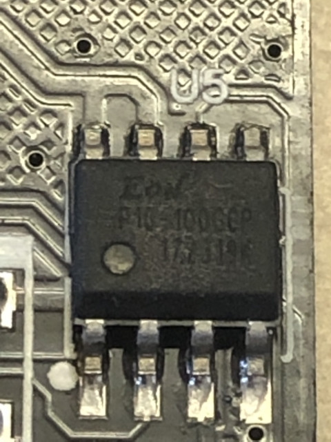

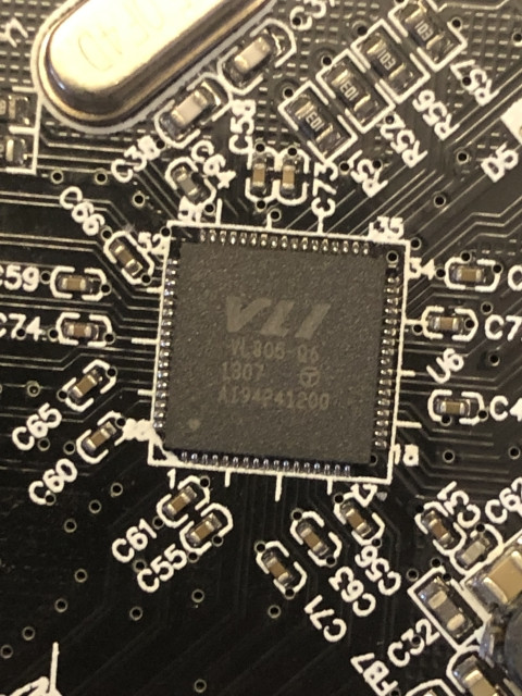

I have exact same 4-port controller you have. (VIA VL805-Q6 controller)
From what i can tell from this card , it has a EON F10-100GCP chip. (see images at end of the post)
If only we could add that chips parameters to the spiflash.ini but i don’t know the correct parameters .
Maybe someone here can help ?

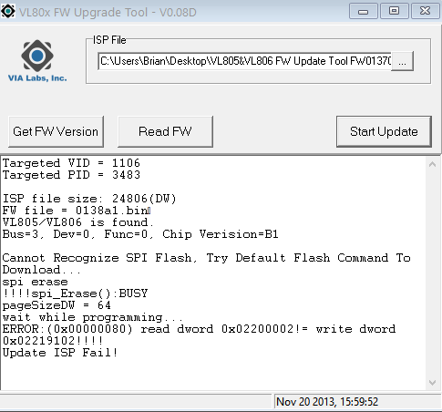

This is what I get when I try to flash ;
Targeted VID = 1106
Targeted PID = 3483
ISP file size: 24806(DW)
FW file = 0138a1.bin
VL805/VL806 is found.
Bus=3, Dev=0, Func=0, Chip Verision=B1
RegAddr:0x80, RegData:0x01, HostState:0x03
After Write, HostState:0x00
Cannot Recognize SPI Flash, Try Default Flash Command To Download…
spi erase
!!!spi_Erase():BUSY
PageSizeDW = 64
wait while programming…
ERROR:(0x00000080) read dword 0x02200002!= write dword 0x02219102!!!
Update ISP Fail!

These are the two chips on the card;

@boombastik :
hi and thanks
I have tried running it as admin and hitting the Start Update button at least 40-50 in succession but nothing works.
i always get this:
2
3
4
5
6
7
8
9
10
11
12
13
14
15
16
Â
Targeted VID = 1106
Targeted PID = 3483
FW file = 0138A1.BIN
, Chip Verision=B1
Cannot Recognize SPI Flash, Try Default Flash Command To Download...
spi erase
!!!!spi_Erase():BUSY
pageSizeDW = 64
wait while programming...
ERROR:(0x00000080) read dword 0x02200002!= write dword 0x02219102!!!!
Update ISP Fail!
Â
I even went as far as trying to install windows xp + 7 on Virtual Machine, but neither will let me access USB sticks .... just hitting brick wall after brick wall lol.
I know the flash tool wiped the chip as it reads back the fw as all 0000000 now, so it must have the potential to rewrite to it ?
I just dont get why it "Cannot Recognize SPI Flash, Try Default Flash Command To Download..."

@xlr8r
"<…just dont get why it "Cannot Recognize SPI Flash, Try Default Flash Command To Download…>"
This is not a problem.

Im about to give up…i have been trying to fix this for a week now and am getting nowhere lol
i have run the FW tool at least 100 times and always same result;
Targeted VID = 1106
Targeted PID = 3483
ISP file size: 24246(DW)
FW file = 013705.bin
, Chip Verision=B1
spi erase
!!!spi_Erase():BUSY
pageSizeDW = 64
ERROR:(0x00000080) read dword 0x02200002!= write dword 0x0221a502!!!
Update ISP Fail!
