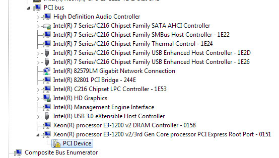

I have a workstation Fujitsu Celsius W520 with Win 7 x64 (MB D3167-A11) and recently bought a Samsung 990 Evo Plus SSD 4TB and a Ugreen PCIe to M.2 Expansion Card and after placing it in the PCIe slot, the card is detected while the SSD disk is shown as “PCI Device” and the system try to install the drivers automatically but can’t find them while searching on “WIndows Update”.
I’ve tried the “Samsung_NVM_Express_Driver_3.3.exe” from Samsung website but it says that no driver is detected.
Can’t get rid of that yellow mark! and it seems that many ppl have this problem and it stays unsolved everywhere.
I know all the things about booting problems from PCIe SSD but “Clover” seems to solve it but only once I’ll manage to make the drive detected and available.
I’ve tried changing PCIe port, uninstall it, “scan for hardware change” and the result is always the same, no way to get it recognized.

The situation however is the in Device Manager it is not shown in “Storage Controllers” but in “Other Devices” => PCI DEVICE and under PCIe Root Port when shown by connection.
Will it be OK anyway to install the “secnvme.inf” in this case?
I earlier tried to install an “nvme.inf” without certificate and had to restore the system…
Let me know what you think about it! I can try the installation…

PCI-DEVICE-ERROR 28
PCI-DEVICE-001

Yes, you can try the driver installation by doing a right-click onto the listed yellow flagged device named “PCI Device” and choosing the “update driver” option. The shown HardwareIDs of the “PCI Device” are the ones of the Samsung SSD’s NVMe Controller!
So… making the “update driver” and choosing the folder with your “64bit Samsung NVMe driver v3.3.0.2003 WHQL for Win7 x64” gave no results, nothing installed!
but !!! :)))
after selecting the other option “Let me pick…” and then selecting “Storage Controllers” and “Have disk” and going to pick your “inf” WOW yes! now it is shown correctly in the device manager but still can’t see it nowhere/browse but I suspect it’s just because needs to be formatted first, right???
