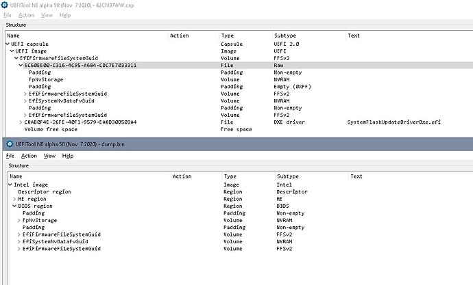

Lenovos bios (cap file) contains bios region and flasher, bios region can be extract with UEFItoolNE. For a complete firmware image, you’re still missing ME and Flas Descriptor. And flashing the extracted region from bios update would not have conserved your specific information, flashing with programmer means overwriting every single bit, and since the update is empty, you’d ended up missing serial instead of wrong serial.
Picture shows old dump and cap file, volume beginning with 6C6… in cap represents bios region. See the second padding in bios region- empty in cap, non- empty in dump that’s one of the regions where board specific information is stored.

You can’t put these data in an update file these regions don’t get updated, otherwise every update would delete this information since an update image comes ‘blank’. So you need to update these areas either by hardware programmer or by fpt (Intel ME tools)
Problem in your old bios is probably here- flash map is missing because of corrupt NVRAM/ EVSA store (looks a little different because of bios versions)
