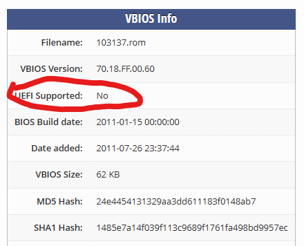

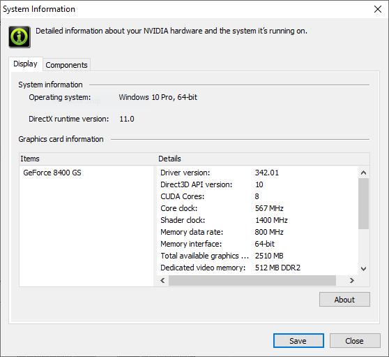

A full UEFI system MUST have in your case (Mb model) also a UEFI GPU, almost sure that that’s the cause of it. So what’s your display card model?
NVMe requires a UEFI environment, such as a modern 64bits OS, GPT file system disk and compatible EFI hardware device initialization, Secure boot Enable or Disable.
I have 2 PCIe slots. 1 X16 and the other 1 X 4. The X4 slot is where my Video card is in.
And the X16 is where the NVMe is plug in.
Richard,
There’s your issue, an old 8400 GS… too old generation that still had no UEFI support, fix it or UEFI boot will never be possible with that card.
A sample…
Only from Nvidia 700 up and a few 600 series started to support EFI, AMD on HD 5000 series.
Case closed, good luck.

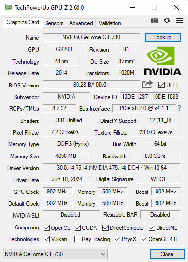

I received my video card today a GeForce GT 730.
Here is the spec’s
As you can see. The VBIOS supports UEFI.

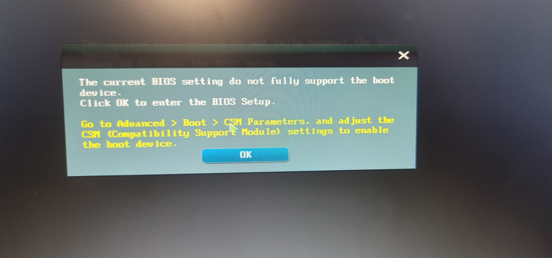

I installed the new card. started up my computer. I got the same message.
So, I reflashed my BIOS the same way as my previous post.
I still not see any changes in the BIOS type change. I reinstalled windows 10.
And got the same message as above. Can anyone tell me why I can’t get this mod to work?

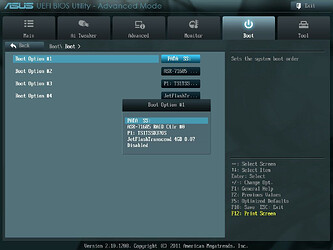

By the way:
After having enabled the “CSM Mode” within the BIOS, a device named “PATA” or “PATA_SS” should be listed within the BIOS as bootable device. This will be the proof, that the NVMe module has been inserted successfully, but nevertheless the booting will not work this way (as mentioned within my Guide).
