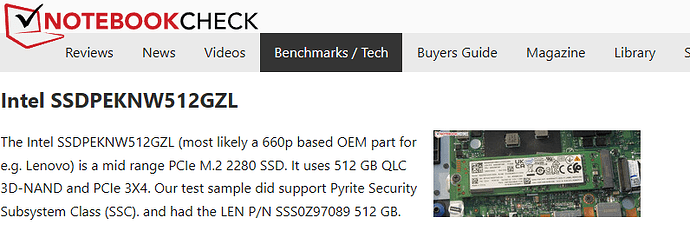

Hello Win-Raid, I’m back on installing windows 7 and i’m doing so far so good, but theres just a tiny bit of a problem im going with. when i was in safe mode it passed the classpnp.sys but it was stuck after with disk.sys I tried to do a follow up with this but i couldn’t understand ANY of it.
keep in mind i have an amd processor (5500U) with an intel oem nvme installed, ill provide the name of the ssd and the storage controller hwid
PCI\VEN_8086&DEV_F1AA&SUBSYS_390F8086&REV_03
INTEL SSDPEKNW512GZL
@ChromifyX
Please expand the “Storage Controllers” section of the Device Manager and post the exact name of the listed NVMe Controller and check again its HardwareID’s. Your posted DeviceID DEV_1AA belongs to the Intel Management Engine Interface (MEI).
weirdly enough, thats the hardware id and according to the sources it is probably based off of the 660p
