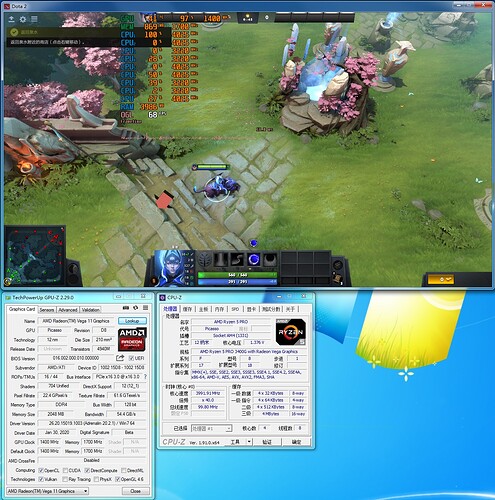

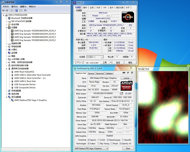

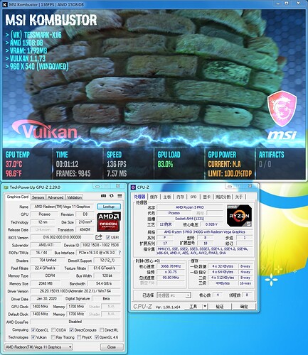

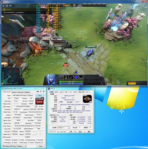

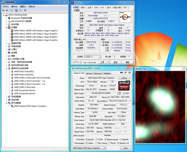

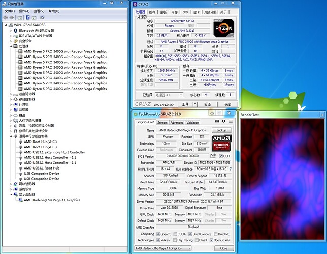

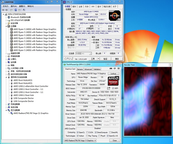

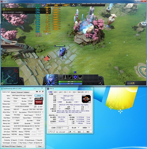

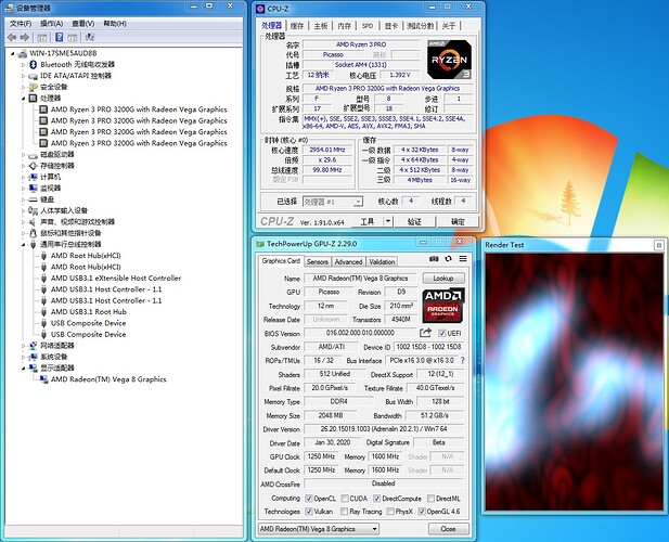

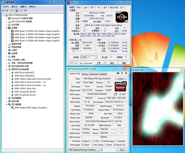

Thanks to a big guy who provided me with the motherboard and CPU test. This test borrowed A320 and B450 motherboards from 4 motherboard manufacturers, and 6 CPUs of 200GE / 2200G / 2400G / 3000G / 3200G / 3400G. Scores, games, and heterogeneous computing all work fine.The driver does not require kernel modification, so it is more stable to use than the modified version of Intel’s graphics driver. As long as AMD updates the driver, I will follow up with the update and keep the new version.Considering the use environment, the driver source package uses the Internet cafe version driver.200GE / 2200G / 2400G —— Raven, corresponding to 2 sets of USB host control, ID is 15E0 / 15E13000G —— Raven2 (native dual-core 4 threads, non-castration) corresponding to 1 set of USB host control, ID is 15E53200G / 3400G ——Picasso, corresponding to 2 sets of USB host control, ID is 15E0 / 15E1200GE
2200G
2400G
3000G
3200G
3400G

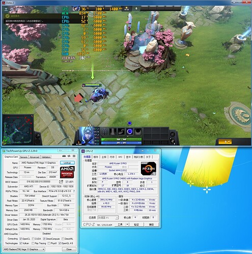

Vulkan API work well.
OpenGL API work well.
DirectX API work well.

ps. no vulkan support ?
@herotoss
I am still trying to fix it.

@herotoss
Vulkan API is supporting and working well now.
