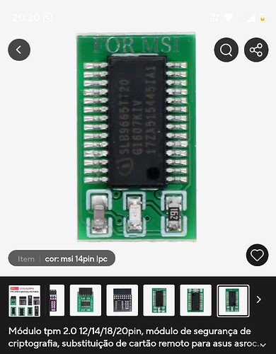

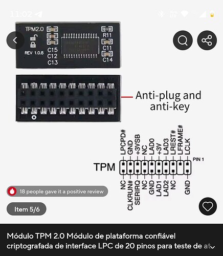

Thank you for answering so fast. Would this one work ? It is lpc 20 pin.
About the bios. I want turbo boost, so need the b2
I changed the ME with M2.rgn
But I didn’t understand what I need to change in the IIO, I need to change it the same as my current bios ?
And I need a external programmer ? I have experience with the ch341, but as you said, I can’t be used because of the 3,3v. Can it be used with a adapter ?
Regarding the TPM, it seems to be the same pinout. However I notice two things here:
  • It is not clearly stated if this is 2.54 or 2.00mm pitch width. You are very likely going to need 2.54mm, to have an easy installation.
  • The modules I have used are long, but this one is flat. So my way of securing the TPM module underneath the motherboard may or may not work. Just pay attention to this, and plan ahead for an easy and reliable installation later on. Really depends completely on your circumstances. Personally I would look for a long module.

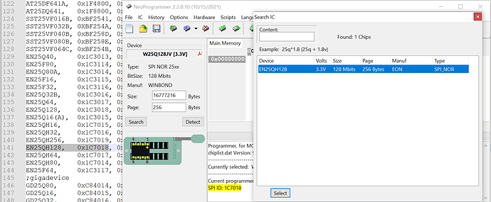

  • I did indeed buy a EN25QH128A flash chip on Taobao. The SPI ID on this flash chip was 1C7018, not 1C7118. See below picture
  • Most importantly: This chip worked perfectly on my modded BIOS, I verified it on my ZX-99EV3. There was actually no need at all to modify the Descriptor Region
  • The three new Huananzhi V6.0 motherboards also have a BIOS available for download. Looking at the “fparts.txt” file shown to the left in below picture, we see SPI ID 1C7018 as well
So my overall conclusion is simple: Although there are new flash chips being used for the Chinese X99 boards, we already have BIOS support for them. So it is unlikely that we will see the same compatibility problems as with for instance the XMC flash chips.
