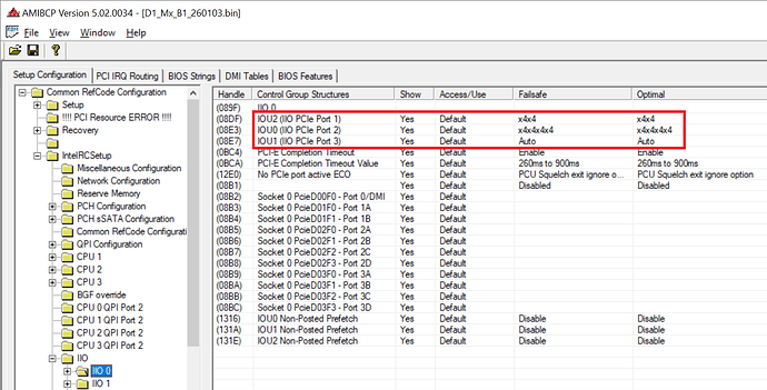

- Step 2: Take the correct ME (Management Engine) region for your motherboard, and swap it in using UEFITool 0.28.0
- Step 3: Use AMIBCP 5.02.0034 and double check that the “IIO 0” setting is the same as your original BIOS
- Step 4: Use an external programmer to flash. Critical: A flasher with 3.3V support is not optional, 5.0V like on older CH341A will very likely kill the newer chips

- Example 2: Machinist X99-PR9 with a 2667V4 chip: Put together a “D1_M3_B1” BIOS, change IIO 0 to x4x4;x16;x8x8
- Example 3: Machinist X99-U9 with a 1650V3 chip: Put together a “D1_M4_B1” BIOS, change IIO 0 to x4x4;Auto;x8x8

See the IIO 0 picture in my latest major BIOS release. Based on my own recent experience, setting IIO 0 correctly before flashing a modded BIOS can under some circumstances (board physical layout, PCIe lanes available from CPU etc) be the difference between getting a picture and not getting one.
